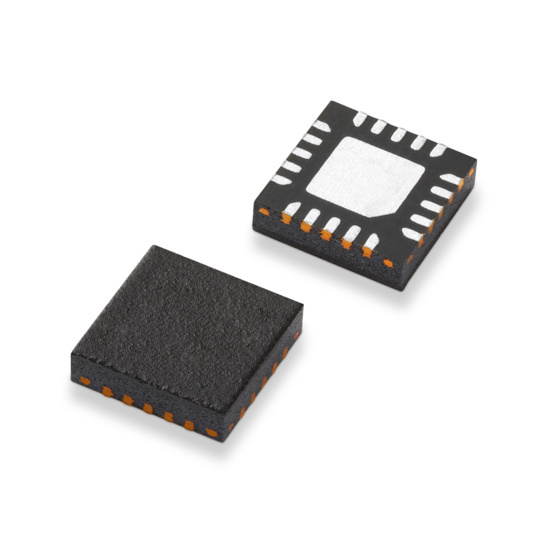

Littelfuse, Inc., an industrial technology manufacturing company empowering a sustainable, connected, and safer world, announced the latest addition to the eFuse Protection ICs product line of versatile circuit protection devices, the LS05006VPQ33. This new eFuse Protective IC's innovative design protects USB Type-C ports against short circuits, overvoltage, and electrostatic discharge (ESD).
This new eFuse Protective IC’s innovative design protects USB Type-C ports against short circuits, overvoltage, and electrostatic discharge (ESD). The LS05006VPQ33 is a highly integrated protection IC for Type-C PD Vbus short to CC/SBU with 28 V max and 8 KV IEC-61000-4-2 ESD capability. View the video.

“The LS05006VPQ33 is an extension of the Littelfuse eFuse protection IC solutions, and it is our first eFuse to support 20 V short, overvoltage, and system ESD protection for signal pins,” said Bernie Hsieh, APM of Protection Semiconductor Business at Littelfuse. “The LS05006VPQ33 provides better reliability, longer life, lower repair costs, and compact product size. It also works well with the LS2406ERQ23 eFuse for Vbus 20-volt, 5 amp protection.”
The LS05006VPQ33 design solves the critical problem of protecting low-voltage silicon circuits in USB Type-C controllers from overvoltage, short circuits, and ESD strikes. Many USB Type-C products don’t meet the Type-C specification, and some adapters that only provide 20 V to Vbus can cause short circuits due to pin issues, twisting, or moisture. Without protection, downstream low-voltage circuits can be damaged. The LS05006VPQ33 ensures that downstream low-voltage circuits are safeguarded against overvoltage and IEC61000-4-2 ESD strikes.
In addition to better reliability, longer life, and lower repair costs, the LS05006VPQ33 also offers other competitive advantages. It supports higher Vmax (28 V) and higher ESD rating at SBU with 8 KV ESD contact compared to other solutions on the market. These benefits make it the perfect solution for electronics engineers looking for a reliable and efficient USB Type-C port protection solution.
