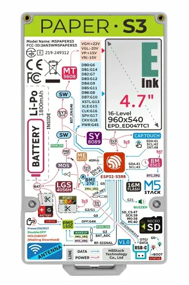

M5PaperS3  ESP32-S3 Development Kit specifications:
  • SoC: ESP32-S3R8
    • Xtensa 32-bit LX7 Dual-Core Processor @ 240MHz
  • Memory:
    • 512KB SRAM
    • 16KB SRAM in RTC
    • 8MB PSRAM
  • Storage:
    • 16MB external Flash
    • microSD card expansion supported
  • Networking:
    • 2.4GHz 802.11b/g/n Wi-Fi and Bluetooth 5.0 with BLE support
    • 20 MHz/40 MHz bandwidth in a 2.4 GHz band
    • Wi-Fi communication range: up to 111 meters (open space, antenna at 90° orientation)
  • Display:
    • 4.7-inch touch-enabled E-Ink screen (EPD_ED047TC1)
    • Resolution: 960×540 pixels (235 PPI)
    • 16-level grayscale
    • GT911 capacitive touch panel with two-point touch and gesture support
  • Sensors: BMI270 gyroscope sensor
  • USB: Type-C USB for OTG/CDC/MSC/Firmware flashing
  • Expansion and Interfaces:
    • 2x GPIO pins
    • HY1.25-4P peripheral interface
    • Built-in RTC chip (BM8563) for deep sleep/wake-up
  • Power Management:
    • LGS4056H battery charging chip
    • Battery: 1800mAh Lithium @ 3.7V
    • Charging current: 5V @ 176mA
    • Input power: 5V @ 500mA
  • Power Consumption:
    • Low power mode: DC 4.2V @ 9.28µA (main power off, gyroscope in low-power mode)
    • Standby mode: DC 4.2V @ 949.58µA (main power off, gyroscope on)
    • Operating mode: DC 4.2V @ 154.02mA (main power on)
  • Miscellaneous:
    • PMS150G for power on/off and program download control
    • Onboard passive buzzer
    • 1x physical button for power/reset/download control
  • Battery Connector: SMT-HDR 1.25-2P
  • Operating Temperature: 0°C to 40°C
  • Dimensions and Weight:
    • Product: 121.5 x 67.7 x 7.7 mm | 89.3 grams
    • Package: 133 x 76 x 19 mm | 112.9 grams
