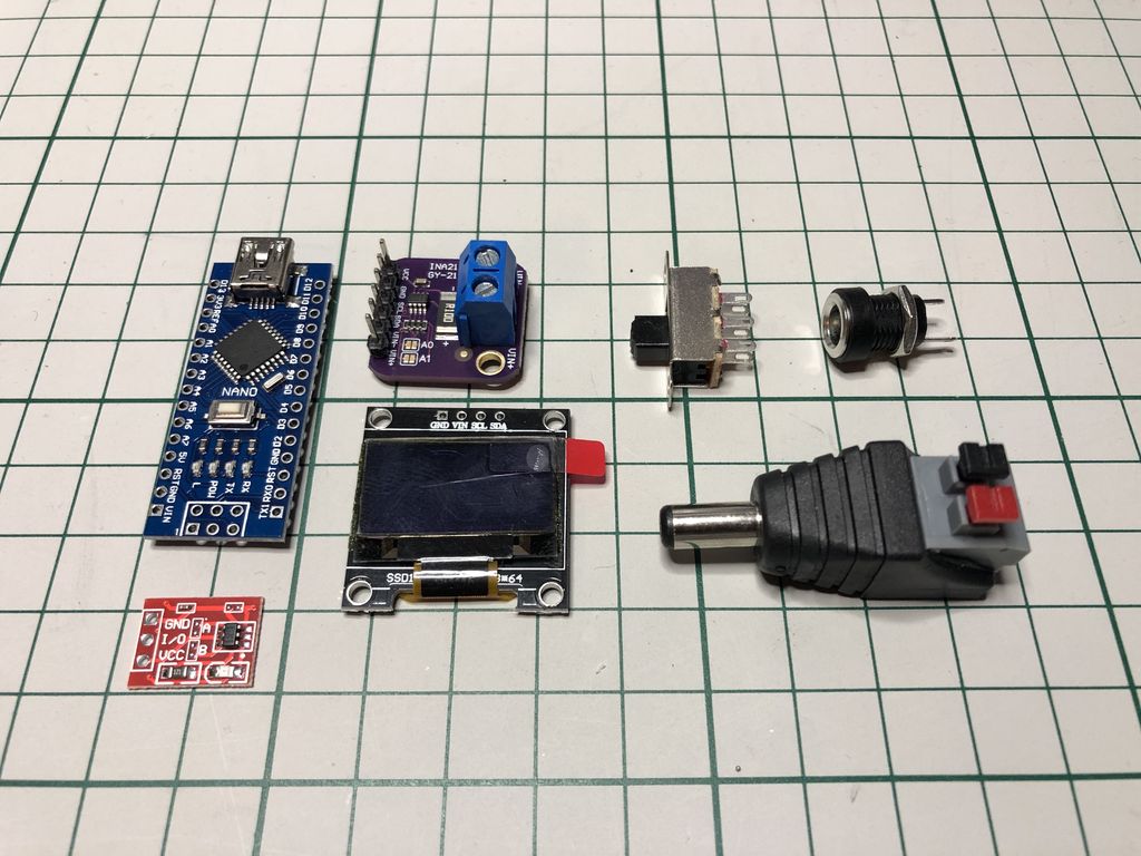

Based on the Arduino Nano, the TinyV/A comprises of the nano, an INA219 sensor, a 0.96” OLED display, and a single capacitive touch button, all neatly housed inside a 3D-printed printed enclosure. It operates in a manner similar man-in-the-middle technique, taken in input from a power supply via a female barrel jack connector and supplying power to the load through a male connector output.
The INA219 is a popular high side current sensor, readily available on Platforms like Alibaba, and its ability to measure both current and voltage on a load is the rock upon which the project is built.
Another interesting element featured in the project is the single capacitive touch buttons which are meant to allow users to easily navigate the Tiny V/A’s menu and change certain settings like the sensor range and refresh rate.
