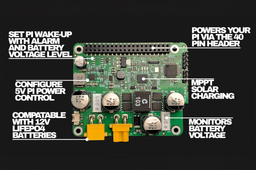

The PV PI is an off-grid solar power manager HAT designed to run Raspberry Pi or any other 5V SBCs 24/7 using a 12V LiFePO4 battery and solar. Developed by AutoEcology, it integrates true MPPT charging, smart power automation, and plug-and-play connectivity to simplify long-term solar operations.
The board is built around a Texas Instruments’ BQ25756 charge controller and an STM32F103 MCU handling MPPT tracking, power monitoring, RTC wake scheduling, watchdog-based cycling, and battery-safe reboot logic. It provides a regulated 5V output via a high-current buck/boost converter, XT30 solar/battery connectors, UART communication with PySerial, external 5V and UART breakouts, and a stackable 40-pin header. These features make this device suitable for solar IoT nodes, off-grid Raspberry Pi projects, environmental logging stations, small autonomous robotics, and remote sensor installations requiring 24/7 uptime.
PV PI Solar HAT Hardware Overview. Images used courtesy of  Kickstarter

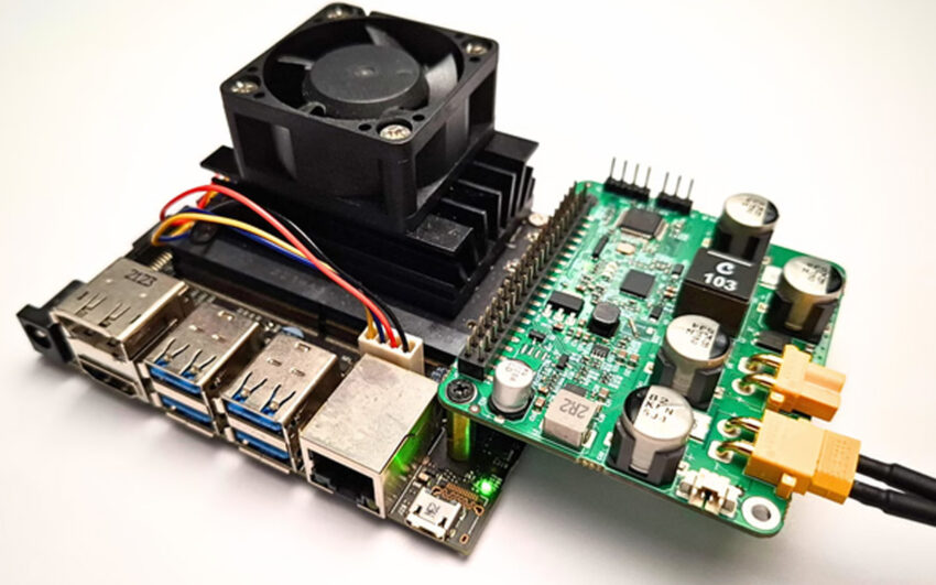

PV Pi with NVIDIA Jetson Development board. Images used courtesy of  Kickstarter
