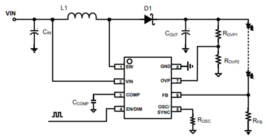

Typical Application
more information: https://www.monolithicpower.com/en/mp3362.html
