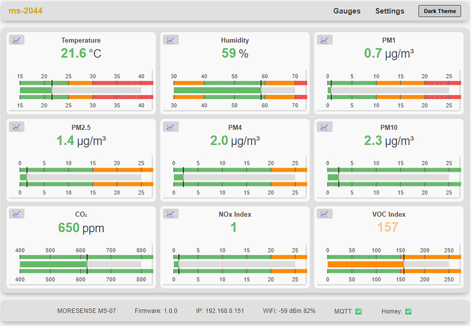

MS-07 Web UI
MS-07 Web UI
The ESP32-S3 firmware has a built-in web server where users can connect from any browser on the local network to a dashboard to view live gauges, analyze up to 1 year of historical data, change settings, and perform OTA firmware updates. It also supports MQTT and MQTT(S) with TLS for secure messaging and a REST API (HTTP GET) for direct data access, so you can integrate it with Home Assistant, Domoticz and Homey without the need for any cloud services. Users can set custom critical (red) and warning (orange) thresholds for each measured parameter for automation. Power is delivered by an integrated 3,180 mAh lithium-ion battery, offering around 10 hours of continuous operation, plus an Eco-mode that significantly increases runtime by decreasing the measurement frequency.
