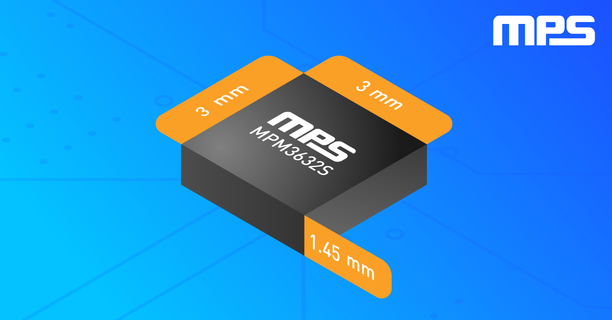

MPM3632S High-Frequency 18 V/3 A DC/DC Regulator with Integrated Inductor
MPS’ MPM3632S offers full protection features, including output OVP, OCP, and thermal shut down MPM3632S from Monolithic Power Systems is asynchronous, rectified, step-down, mini-module regulator with built-in power MOSFETs, an inductor, and two capacitors. It offers a compact solution with only input and output capacitors to achieve a 3 A continuous output current with excellent load and line regulation over a wide input supply range.
Power by mixos
MPM3632S from Monolithic Power Systems is asynchronous, rectified, step-down, mini-module regulator with built-in power MOSFETs, an inductor, and two capacitors. It offers a compact solution with only input and output capacitors to achieve a 3 A continuous output current with excellent load and line regulation over a wide input supply range. The device operates in a fixed 2.2 MHz switching frequency with constant on-time (COT) control to provide a fast load transient response. The MPM3632S offers full protection features, including output overvoltage protection (OVP), overcurrent protection (OCP), and thermal shut down. The MPM3632S is available in an EC LGA-10 (3 mm x 3 mm x 1.45 mm) package.
  • Wide 4 V to 18 V operation input range
  • 0.5% accuracy output voltage
  • 3 A continuous output current
  • 2.2 MHz switching frequency
  • Power good indicator
  • Hiccup OCP protection
  • Output OVP protection
  • Fast transient response
  • Internally fixed soft-start time
  • Forced CCM mode
  • Available in an EC LGA-10 (3 mm x 3 mm) package
