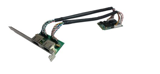

MPX-350 - Mini-PCI Express Dual Gigabit Ethernet Module with Intel® I350-AM2. Features Low power consumption and high performance One PCIe lane to Dual Gigabit LAN Support Mini card PCI-E 1.1 & 1.2 standard specification Support WOL and PXE Specifications Host Interface: PCI-E Controller: Intel® I350-AM2 Dual Gigabit Ethernet Controller Dimension: 30.00mm x 50.95mm Weight: 3g Voltage: 3.3V +/-5% Temperature: 0~55°C Storage Temperature: -40~+85°C Compliance: IEEE 802.3 Ethernet interface for 1000Base-T, 100Base-TX, and 10Base-T applications (802.3, 802.3u, 802.3ab).
MPX-350 – Mini-PCI Express Dual Gigabit Ethernet Module with Intel® I350-AM2.
  • Low power consumption and high performance
  • One PCIe lane to Dual Gigabit LAN
  • Support Mini card PCI-E 1.1 & 1.2 standard specification
  • Support WOL and PXE
Specifications
  • Host Interface: PCI-E
  • Controller: Intel® I350-AM2 Dual Gigabit Ethernet Controller
  • Dimension: 30.00mm x 50.95mm
  • Weight: 3g
  • Voltage: 3.3V +/-5%
  • Temperature: 0~55°C
  • Storage Temperature: -40~+85°C
  • Compliance: IEEE 802.3 Ethernet interface for 1000Base-T, 100Base-TX, and 10Base-T applications (802.3, 802.3u, 802.3ab).
  • Advanced technologies: I/O Virtualization , WoL, VLAN filtering, PXE remote boot
  • Transfer Rate: 1000 Mb/s, 100 Mb/s, or 10 Mb/s
  • Support OS: Win7 x32&x64, Win8 x32&x64, Win8.1 x32&x64, Win10 x32&x64, Win server 2012 R2.Linux (kernel versions 2.6.30 or newer
Connection cables and dual RJ45 adapter
