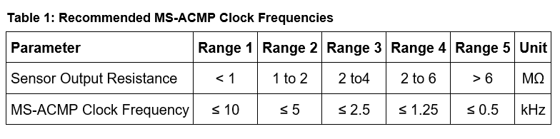

The MS-ACMP uses the internal oscillator (OSC0) or an external clock (max. 10 kHz with 50% duty cycle) to switch between channels, change VREF, and latch the results. The clock from OSC0 can be divided by 2, 4, or 8 within the MS-ACMP. If the ‘Auto Power-on’ setting of OSC0 is selected, a HIGH-level voltage (or a rising edge depending on the setting) on the EN input starts the internal oscillator (OSC0). Table 1 shows the recommended MS-ACMP clock frequencies when interfacing sensors with high output impedance.
