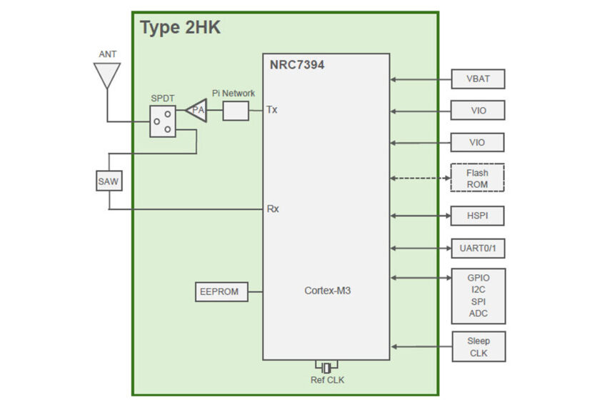

Type 2HK Block Diagram

Type 2HL Block Diagram
