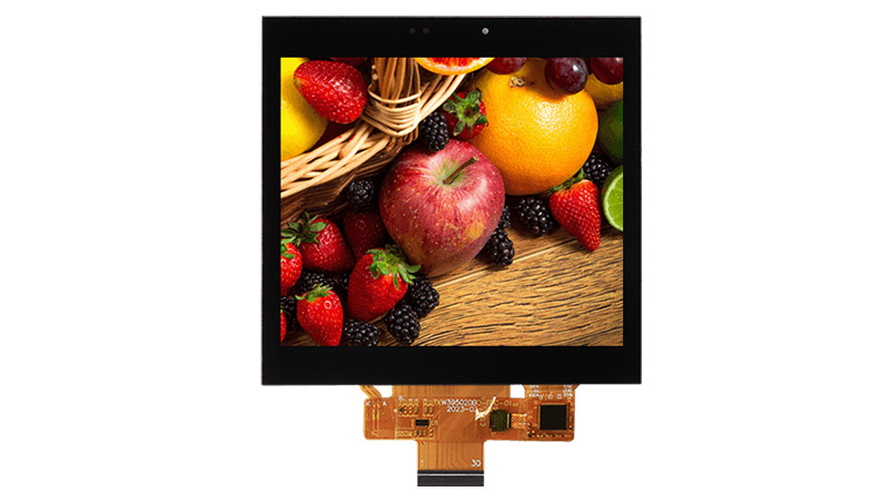

Osptek YDP400BT001-V4 is a TFT LCD with a resolution of 720×720, a universal MIPI interface and comfortable viewing from any angle. The LCM module includes a ST7703I controller, and the CTP includes a GT911 controller. It has FPC plug-in interface, is RoHS compliant and has capacitive touch function.

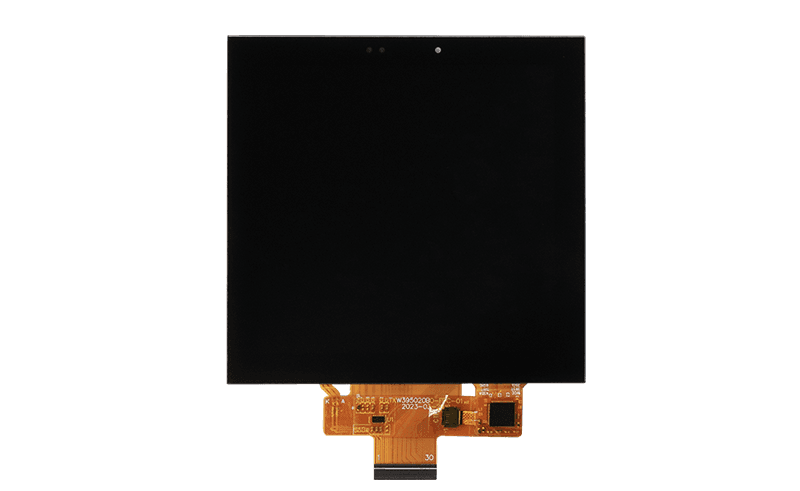

Osptek YDP400BT001-V4 TFT LCDOsptek YDP400BT001-V4 TFT LCD
Osptek YDP400BT001-V4 Specifications:
  • Model: Osptek YDP400BT001-V4
  • Display Size: 4.0-inch TFT LCD touchscreen
  • LCD Type: Black (Normal)
  • Drive Element: TFT Active Matrix
  • Resolution: 720 × 720 pixels
  • Pixel Arrangement: RGB Vertical Stripe
  • Panel Technology: TFT display with capacitive touch support
  • Viewing Angle: Full viewing angle for enhanced visibility
  • Display Interface: Universal MIPI interface (4-lane)
  • Display Driver IC: ST7703
  • Touch Controller IC: GT911
  • Supply Voltage: 2.8V
  • Back Panel: White LED Back Light
  • Connector Type: 30-pin FPC connector
  • Module Dimensions (L × W × H): 86.00 × 86.00 × 4.23 mm
  • Active Display Area: 71.93 × 71.93 mm
  • Operating Temperature Range: -20°C to +60°C
  • Storage Temperature Range: -30°C to +70°C
