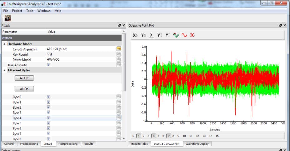

Example of Chipwhisperer Analyzer Software
