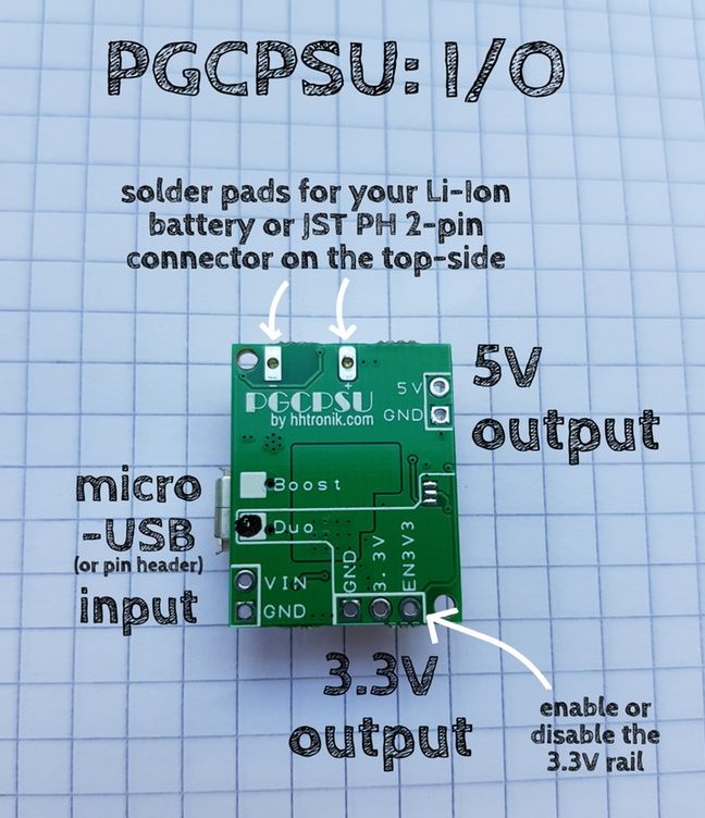

PGCPSU is a three in one power supply board: it integrates a lithium battery charge management circuit with 5V and 3.3V DC-DC converter-based output rails to power most projects in a very compact form factor. We took special care in selecting inexpensive yet well-fitting parts to make up for a great little power(ful) supply!
  • Power Input – micro USB input or pin header for charging (4.7V to 6V max.)
  • Power Output
    • 5V rail providing at least 350mA, and up to 650mA
    • 3.3V rail providing at least 400mA, and up to 800mA
  • Safety
    • Integrated battery protection including reverse polarity protection
    • Over-discharge, short circuit/over-current protection

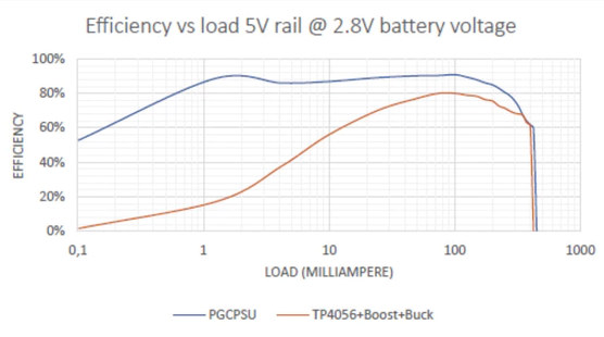

  • Power Efficiency
    • High efficiency even at low load, important for long battery life
    • Low quiescent current (49uA for the 5V rail + 57uA for the 3.3V rail)
    • Enable/disable pin for the 3.3V rail with selectable default state solder jumper
  • Charging –  Quick charging at up to 1.9A (fully charges a 2,600mAh cell in about 2 hours)
  • Dimensions – 25x20mm
The module can also be used as an uninterruptible power supply.
