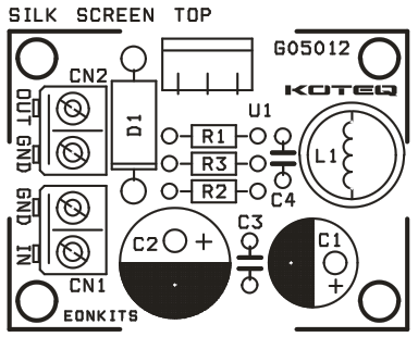

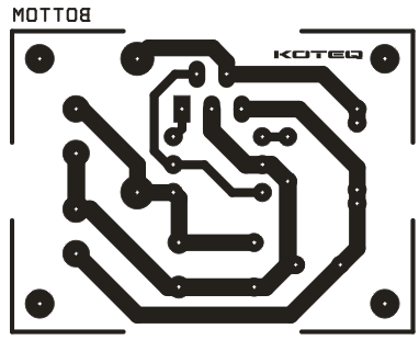

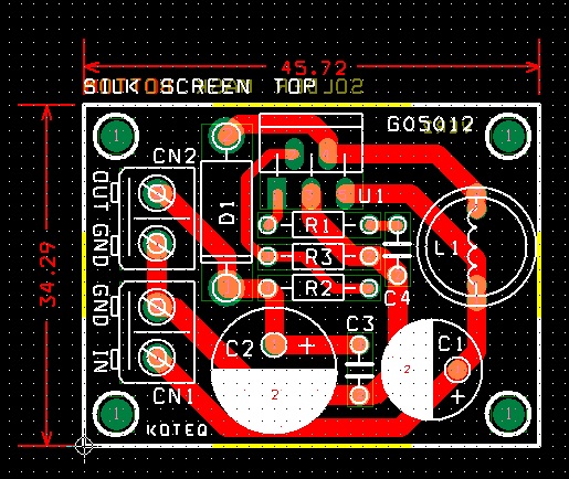

- PCB Dimensions: 45.72 x 34.29 mm

What will be the PCB dimensions and diode 1N5822 is not available will Diode 1N5819 will do? Plus SMD Capacitor 330nf 1206 is this ok?
Try to print the PCB from the PDF file and it will be in correct dimensions. The diode used in this project is rated at 3A but the diode you mention is rated at 1A so there is possibility of damaging the diode on full output. Capacitor C4 should work fine.

Dear, where can i find the dimensions of the printboard?
Thanks!
Hi, Dimension for this PCB 45.72X34.29MM
I’ve updated the project with PCB dimensions.

Where can i get the pcb printed
We provide the files to build your own PCB. Would you like to get Gerber files as well?

Please share the gerber files
Gerber files added above. Thanks
