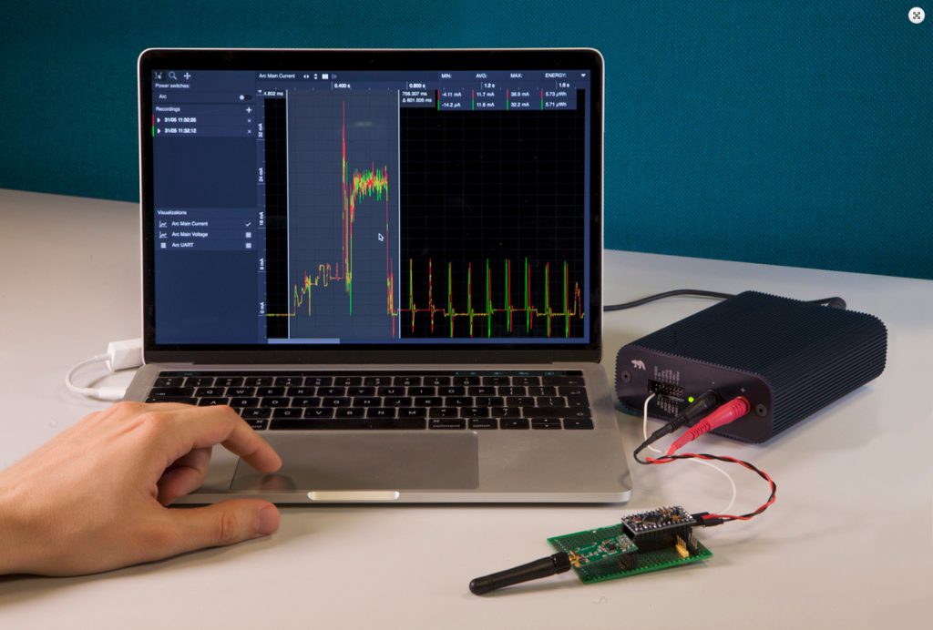

Otii provides developers with the means to simplify power measurement of applications and devices, especially those targeting the IoT space and aiming for optimised, long battery life. Otii combines the measurement capabilities of several test and measurement hardware tools into the Otii Arc, a device that makes it substantially easier for developers to pinpoint which sections of code, associated peripherals, and hardware contribute most to the application’s power consumption.
Powered by a PC’s USB port or an external 7.0 to 9.0V power supply, the Otii Arc provides power to the target application whilst measuring and displaying power consumption from below one microA to 5.0A without the need to manually change the settings.
As well as measuring power consumption, the Otii Arc, together with the accompanying Otii software, can also monitor additional analogue and digital signals, allowing application sub-systems to be monitored in parallel to the main power input. Any serial data, from 9600bit per second to 4Mbit per second, output by the target can also be synchronously captured and time-stamped.
Qoitech’s Otii software runs on Windows, macOS and Ubuntu Linux. The developer can review power consumption from a development PC and share and compare the results with colleagues, customers and suppliers. The software increases usability when compared to traditional test and measurement tools, claims Digi-Key, as these can require results to be displayed on the tool itself, or to be exported for later analysis in a spreadsheet without the test settings and related context of the application.
