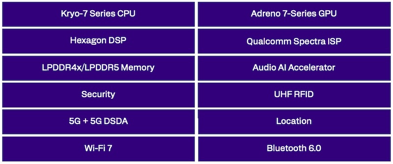

Qualcomm Dragonwing Q-6690 Block Diagram
Block diagram of the Dragonwing Q-6690. Image used courtesy of Qualcomm
Connectivity is a key focus, with the Q-6690 supporting a robust suite of next-gen standards. It includes integrated 5G, Wi-Fi 7, Bluetooth 6.0, and Ultra-Wideband (UWB). The integrated modem supports 5G+5G Dual-SIM Dual-Active (DSDA) connectivity, providing failover redundancy crucial for mission-critical enterprise applications.
This design also enables the RFID functionality to operate concurrently with other integrated radios without interference. The device also supports a wide range of I/O capabilities, including PCIe Gen 3 and USB 3.1 Type-C.
