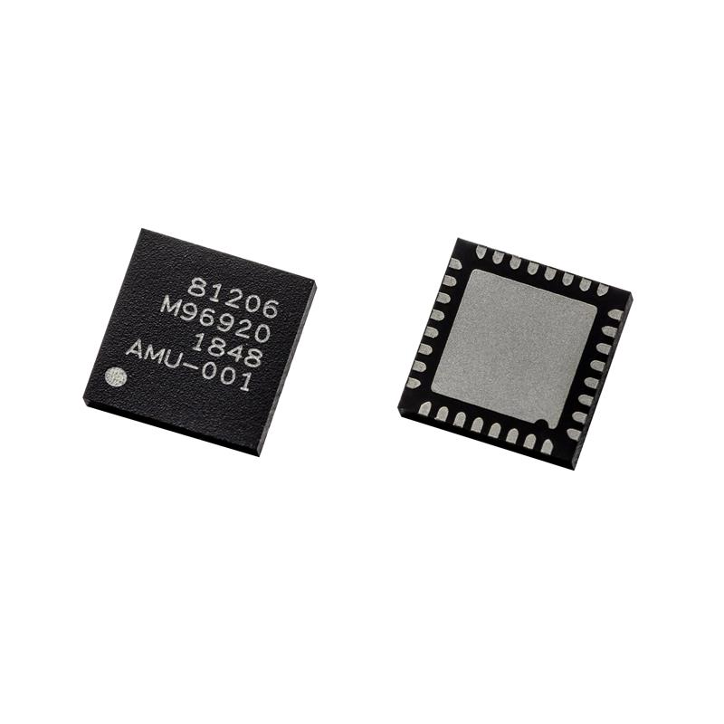

Melexis announces the latest addition to its generation II embedded motor driver product portfolio for automotive applications, with the release of the MLX81206. This single-chip solution with 64 KB Flash memory offers higher integration with the ability to drive BLDC motors from 100 W to 1,000 W.
The MLX81206 supports a LIN 1.x/LIN 2.x and SAE J602 compliant interface, the most widely used digital communications interface standards in the automotive sector, making it a simple solution to predriving a range of high-power BLDC motors. With the ability to drive 12 V motors in either a sensor or sensorless configuration the MLX81206 is the ideal choice for silent and high-performance HVAC blowers, engine cooling fans and pumps in conventional, hybrid and full electric vehicles.
Melexis engineers have achieved a high level of integration, bringing together an embedded driver with high-voltage analog circuitry and digital technology, including Flash and non-volatile RAM memory along with an embedded microcontroller. This makes the MLX81206 a highly efficient and complete single-chip solution combining both hardware and software.
The synergy between sensing and drive control makes the MLX81206 a compelling choice in terms of size, performance and robustness. This is apparent by the ease with which the device can interface to a range of sensors, such as the MLX90380 resolver for dynamic pumps driven in Field-Oriented-Control (FOC) mode. This IC can be delivered in a small footprint QFN32 package (MLX81206) or in a leaded package TQFP48 (MLX81208).
