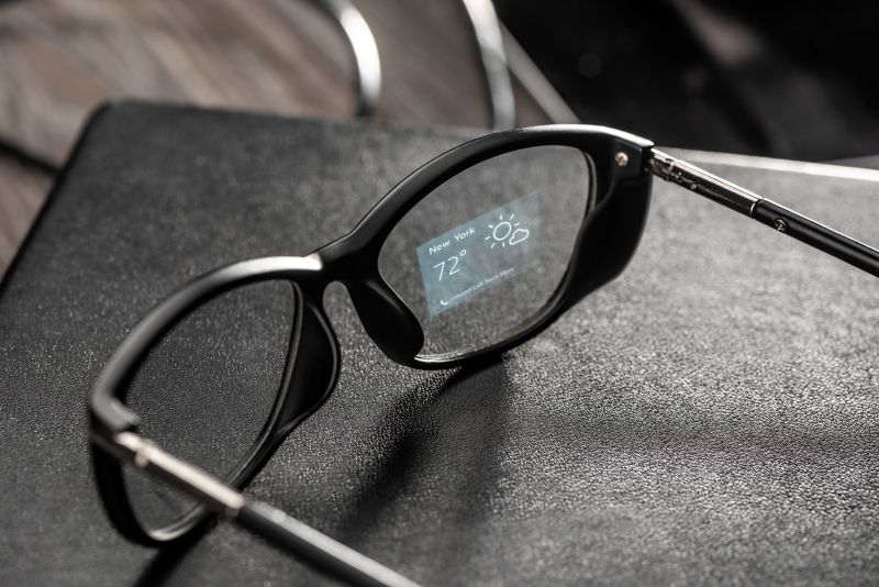

TDK’s ICM-45685 sensor can detect head orientation, activity, and other features that enable augmented reality in smart glasses
TDK’s ICM-45685 sensor can detect head orientation, activity, and other features that enable augmented reality in smart glasses. Image used courtesy of TDK Corporation
