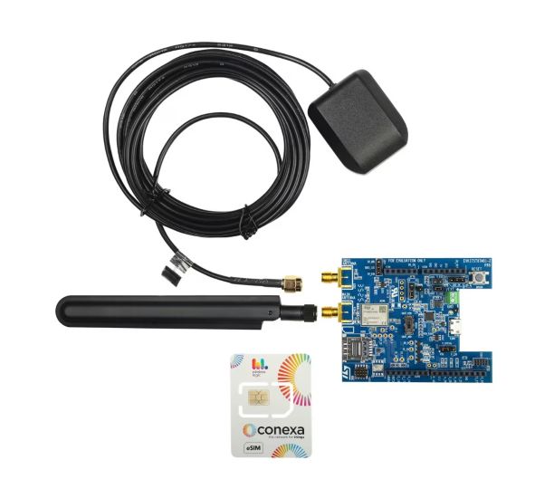

The EVKITST87M01-2 evaluation kit for prototyping NB-IoT modules
The EVKITST87M01-2 evaluation kit for prototyping NB-IoT modules. Image used courtesy of STMicroelectronics
For hardware evaluation, the EVKITST87M01-2 offers a complete prototyping platform. The kit includes a ready-to-use IoT SIM card provided by Wireless Logic, operating on the Conexa network. This pre-provisioned connectivity enables designers to immediately test NB-IoT data transmission across Europe, the Middle East, and Africa.
