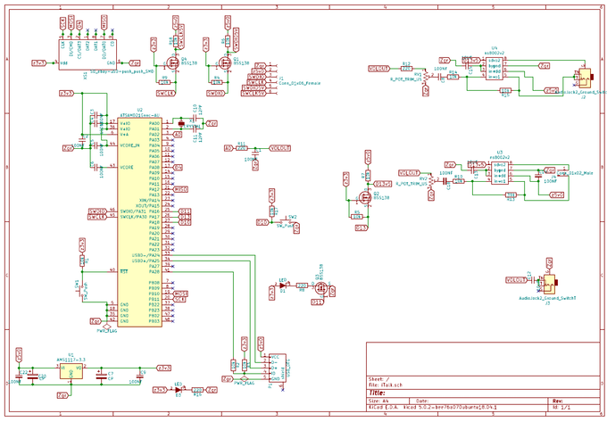

Hardware
Build in 3W speaker amplifier with a trimmer for the speaker volume, an audio line output jack and  headphone amplifier.  lt also includes a separate trimmer for the headphone volume.
A low-pass RC filter is used to cut any high frequency noise.
The word synthesis is done with an SAMD21G18 micro controller, running with an Arduino Zero bootloader.
You must always power the board with 5v. Text is sent to the board thru USB Serial communication or by UART connection. There is a level shifter so a 5v (Arduino UNO, etc) or a 3.3v (Arduino Zero, Raspberry Pi, etc.)  micro controller can be used.  Both can work simultaneously.
The default serial speed is 9600, but the speed can be changed by editing the file ‘setup.txt’ found in the SD card. In this file you can also change the bit rate (default 22050), the bit resolution (default 8 bits), and the speed of the text (default  100).
An error LED is turned on when a word is not found in the SD card. Also there is a test button, so you can hear that the board is working
