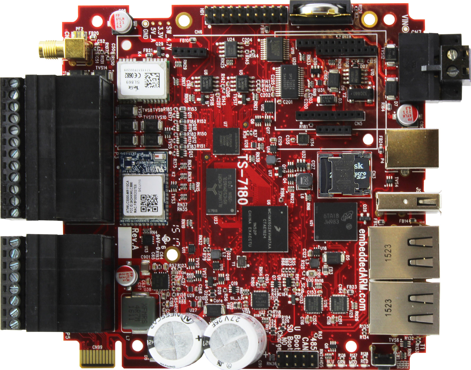

Toradex has recently introduced the Ivy Carrier Board, an industrial-grade carrier board designed for the Verdin System on Module (SoM) family, optimized for demanding environments with a compact form factor of 130 x 105 mm. The board is built for volume production offering scalable performance, cost-effectiveness, and open-source hardware support.
Ivy Carrier Board
Toradex has recently introduced the Ivy Carrier Board, an industrial-grade carrier board designed for the Verdin System on Module (SoM) family, optimized for demanding environments with a compact form factor of 130 x 105 mm. The board is built for volume production offering scalable performance, cost-effectiveness, and open-source hardware support. It features robust connectivity, including dual Gigabit Ethernet, USB 3.0 and 2.0 ports, Mini PCIe, I2C, SPI, UART (RS232 and RS485), isolated GPIO, analog inputs, SDIO, and dual CAN interfaces with transceivers.
