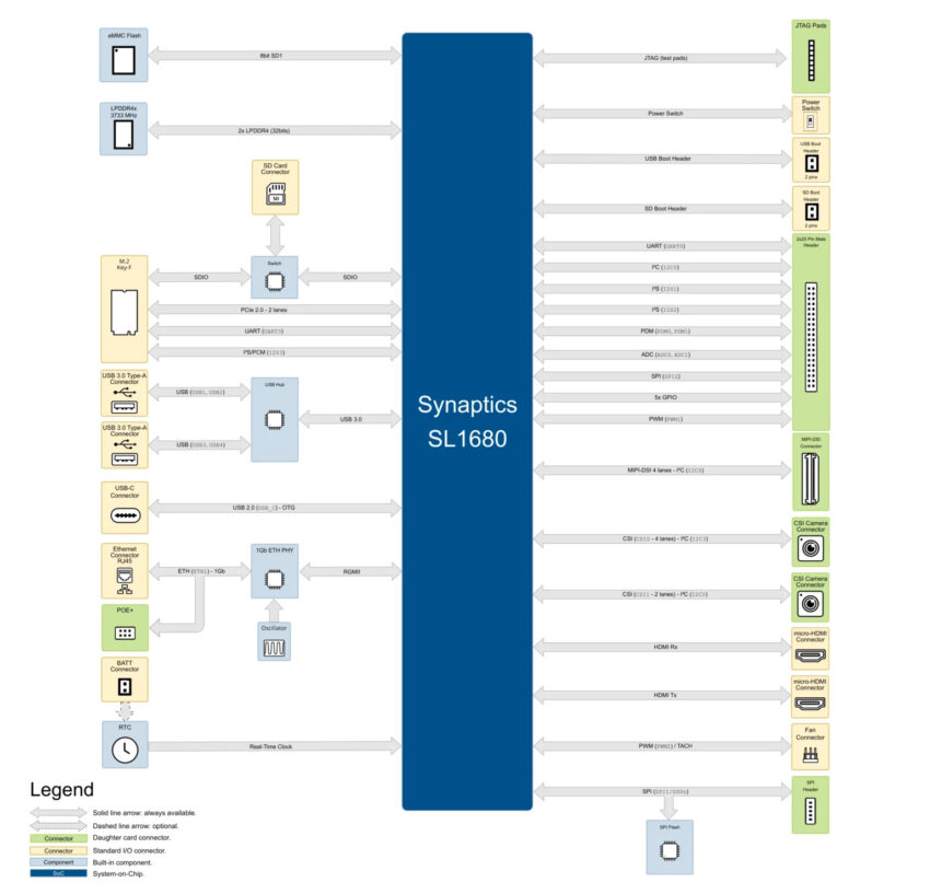

Toradex Luna SL1680 Edge AI SBC Block Diagram

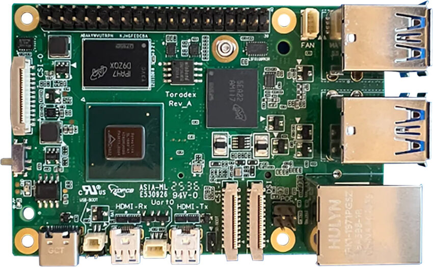

Luna SL1680 Edge AI SBC Top View
Toradex Luna SL1680 Top View
