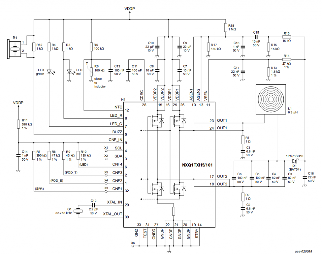

Creating a Qi-compatible is as easy as assembling the example circuit shown in figure one. From a technical point of view, the diagram is full of decoupling capacitors but does not require much in terms of complexity. The main issues are a) finding a correct coil and b) prototyping the device – NXP uses a 5 mm x 5 mm, 32-pin HVQFN package which is not really suited to non-reflow soldering processes.

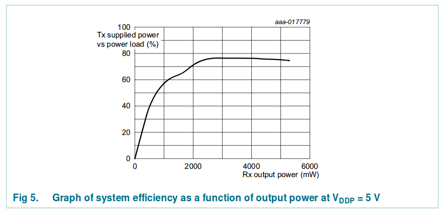

While most charging ICs limit themselves to simply providing the oscillating field needed for transferring power, NXP adds a few extremely nifty features to its chip. First of all, the NXQ1TXH5 is able to monitor and restrict the amount of power supplied to its clients. This way, multiple chips can power themselves from a single USB wallwart. Sadly, this process does not have unlimited efficiency – look at figure two to see a power derating curve.
…QI’s already-bad efficiency becomes terrible if but small amounts of power are to be transferred
