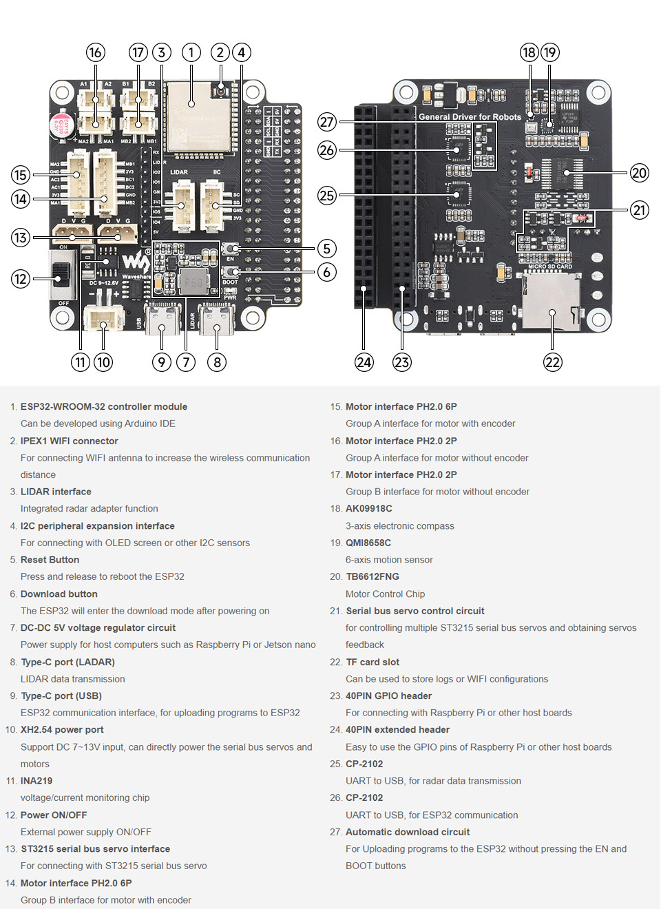

Key features include support for wireless and wired control (WiFi, ESP-NOW, UART, and USB), an OLED display, I2C/SPI interfaces, LiDAR compatibility, and an expansion header for Raspberry Pi or other host devices. Sensors like a 3-axis compass, 6-axis motion sensor, and current monitoring chip enable versatile applications. It also supports software tools like the Arduino IDE, ROS2, and a web-based control interface for cross-platform usage. With customizable end-of-arm tools and mounting options, the RoArm-M2 is ideal for tasks like robotics education, automation demos, research, and interactive DIY projects.

  • Control Board: ESP32-based
  • Degrees of Freedom (DOF): 4-DOF robotic arm
  • Servos:
    • Supports 3x standard servos
    • Supports 1x bus servo
  • Materials: Carbon fiber arm structure
  • Connectivity:
    • USB interface
    • Wi-Fi communication (ESP32)
  • I/O and Interfaces:
    • I2C interface
    • LiDAR support
    • UART for bus servo control
  • Power Supply
    • 12V, 5A power supply with 2-channel supply switch
    • Supports 3S Lithium batteries (NOT included)
