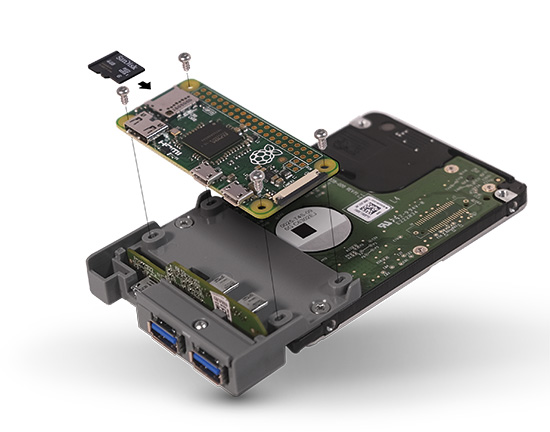

WD PiDrive Node Zero Exploded View
The WD PiDrive Node Zero comes with a 4GB microSD preloaded with a customized version of the popular NOOBS (New Out of Box Software). On first boot, Raspbian gets installed in the primary hard disk and not on the 4GB microSD. The SD card boots the device, but you run it from the hard drive. So you do not have to switch between the two drives.

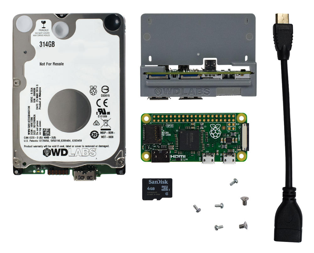

The WD PiDrive Node Zero kit comes with the following:
  • WD PiDrive 314GB
  • Raspberry Pi Zero
  • USB Adapter board (PCBA) with full sized ports
  • 4GB microSD card (with preloaded software)
  • Mini HDMI adapter cable
