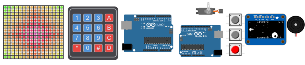

Left to right: NeoPixel matrix, keypad, servo and the spaceship game, all available in the Arduino Playground
