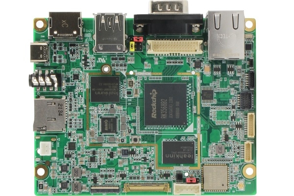

AAEON is now inclining to a slightly wider form factor with its new RICO-3568 based on Rockchip RK3568 Quad-Core Arm® Cortex®-A55 Processor. Adhering to the Pico-ITX Plus form factor which is 100mm x 80mm in dimension, it seems the extra 8mm in its size compared to the array of AAEON Pico-ITX Boards, this one has more scope for interfaces.
The Rockchip RK3568 in the RICO-3568 means an integrated NPU with 0.8 TOPS and an Arm® Mali™-G52 GPU accompanying this Pico-ITX Fanless Board. The memory interface of RK3568 supports 32-bit DDR4, DDR3L, LP4, and LP4x with ECC, but the RICO-3568 optionally has Onboard LPDDR4 up to 8GB, while for storage the board is equipped with 16GB eMMC and Micro-SD card, along with a full-size mini-PCIe slot.

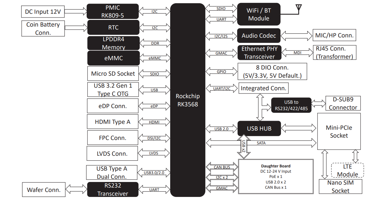

RICO-3568 Block Diagram
The RICO-3568 allows a few expansions. It includes a full-size mini-PCIe slot, which supports both mSATA and USB devices, providing flexibility for storage and peripheral connectivity. Additionally, eight GPIO pins are accessible via a 2×6-pin Wafer, allowing for various custom hardware integrations. A 40-pin FPC connector further expands its functionality, supporting a daughter board that includes CAN Bus for automotive applications, two I2C interfaces for connecting sensors and other I2C devices, and GMAC for Ethernet connectivity, enhancing its suitability for diverse smart building and industrial applications.
