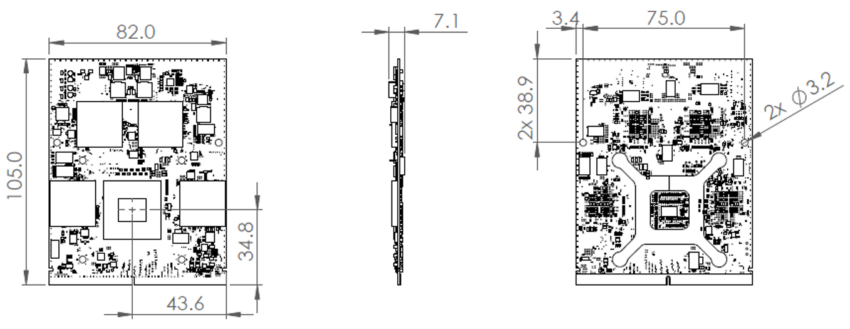

AI-MXM-H84A AI accelerator module hardware overview
Specifications of the AI-MXM-H84A AI accelerator module:
  • Hardware system: AI-MXM-H84A AI accelerator module
  • Processor core: 4x Hailo-8 AI processors
  • AI performance: 104 TOPS
  • Form factor: MXM 3.1 Type-B
  • Display ports: No display outputs
  • Interface: PCI Express 3.0 x16
  • Max power consumption: 115W
  • Power: Bus powered
  • Cooling: Passive, no fans
  • Dimensions: 82×105 mm
