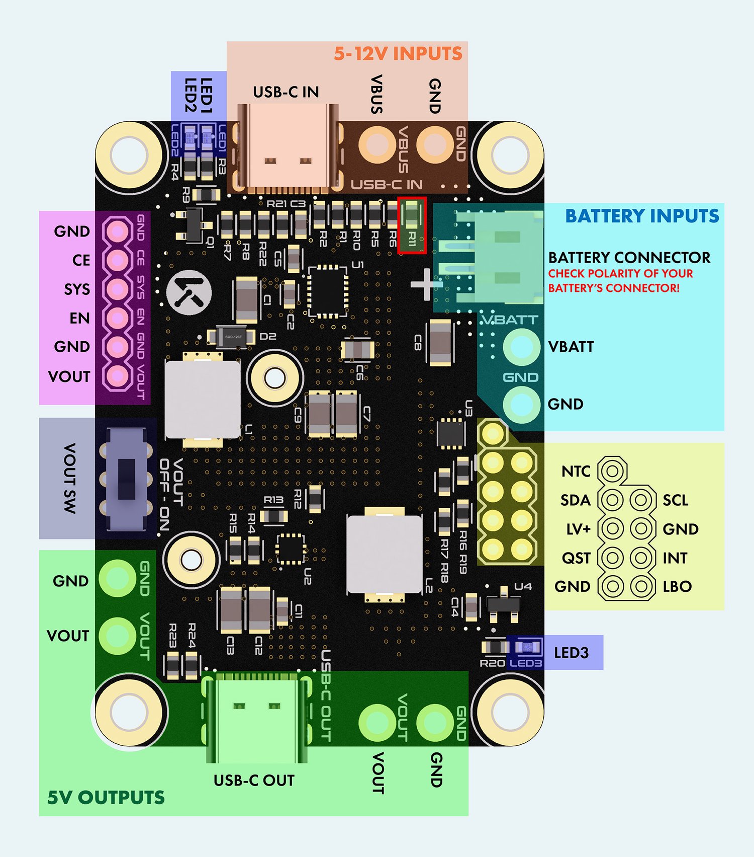

In September 2021, the AmpRipper 3000 was unveiled, utilizing the Monolithic Power MP2624 to convert almost any lithium-ion or lithium-polymer battery with an output of 3.7V to 4.2V into a power source for DIY electronic projects. However, the AR4000 makes use of Monolithic’s MP2617 and MP3424 boost converter, which can provide up to 4A of power – a third more than the previous model. For those who don’t need a USB, the power output is also available on through-hole terminals.

The AR4000 module ensures that power to your project is not interrupted, even if the battery or charger is removed, by utilizing Mart Power Path Management Technology. It also accepts a wider input voltage range of 5-14V compared to its predecessor and is compatible with 3.7-4.2V 1S[N]P lithium-ion/polymer batteries. Additionally, the MAX17048 battery monitor allows for the monitoring of battery voltage and charge percentage via I2C. Furthermore, AR4000 offers improved accessibility with more i/o and expanded connectivity options, including USB-C and thru-hole terminals for power input and output, as well as a JST PH-2.0 connector and thru-hole terminals for the battery. The AmpRipper 4000 has the same design as its predecessor, but the USB Type-A port has been removed. The new design also features an Analog Devices MAX17048 battery monitor, which can be accessed via I2C to check the battery voltage and charge percentage. Additionally, an optional custom heatsink and fan assembly are included, which is recommended if the board is expected to be running at its highest capacity for extended periods.
