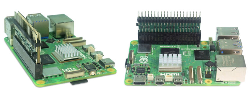

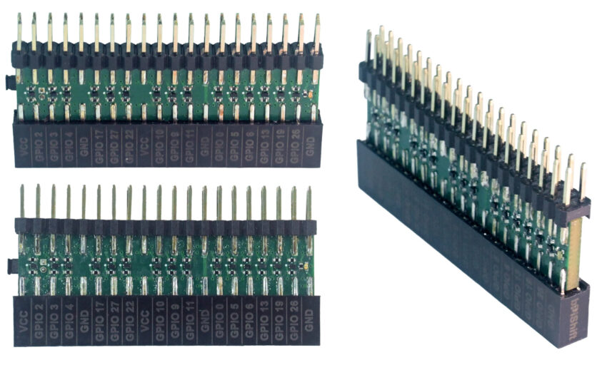

bPiShift: Front, Back, and Side View

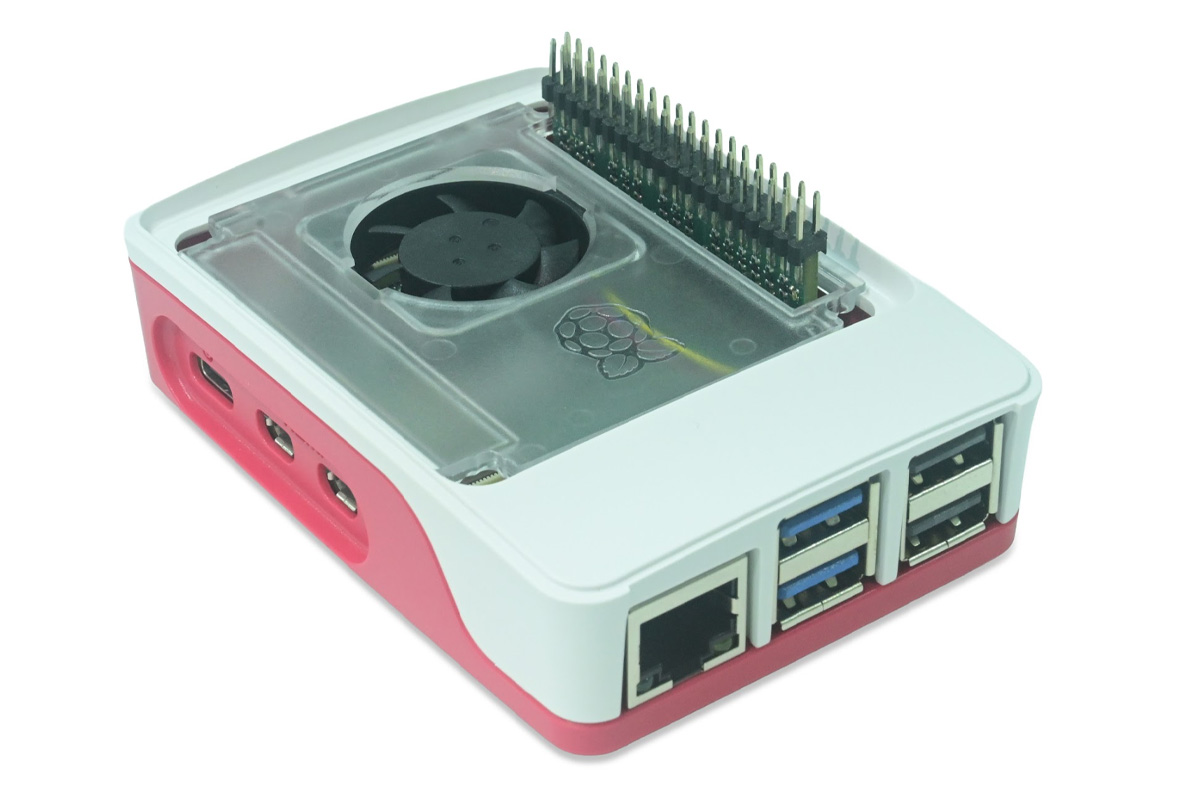

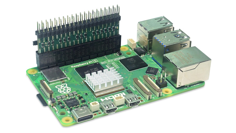

PiShift connected to a Raspberry Pi
PiShift inside the Pi case
