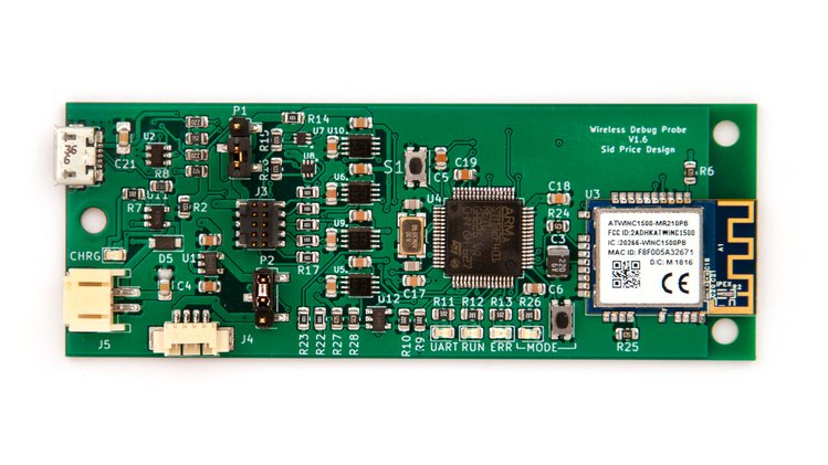

ctxLink is an open hardware debugger, based on the Black Magic Probe (BMP), that supports Wi-Fi connectivity and battery powered operation. It implements SWD and JTAG interfaces for remote, cable-free programming and debugging of ARM Cortex-M microcontrollers.
ctxLink is an open hardware debugger, based on the Black Magic Probe (BMP), that supports Wi-Fi connectivity and battery powered operation. It implements SWD and JTAG interfaces for remote, cable-free programming and debugging of ARM Cortex-M microcontrollers. It is ideal for debugging mobile projects such as robotic devices and other embedded systems that are not always physically accessible.

  • Microcontroller: STM32F401RE
  • Wi-Fi module: Microchip WINC1500
  • Physical: 89 mm x 33 mm, 4-layer PCB
