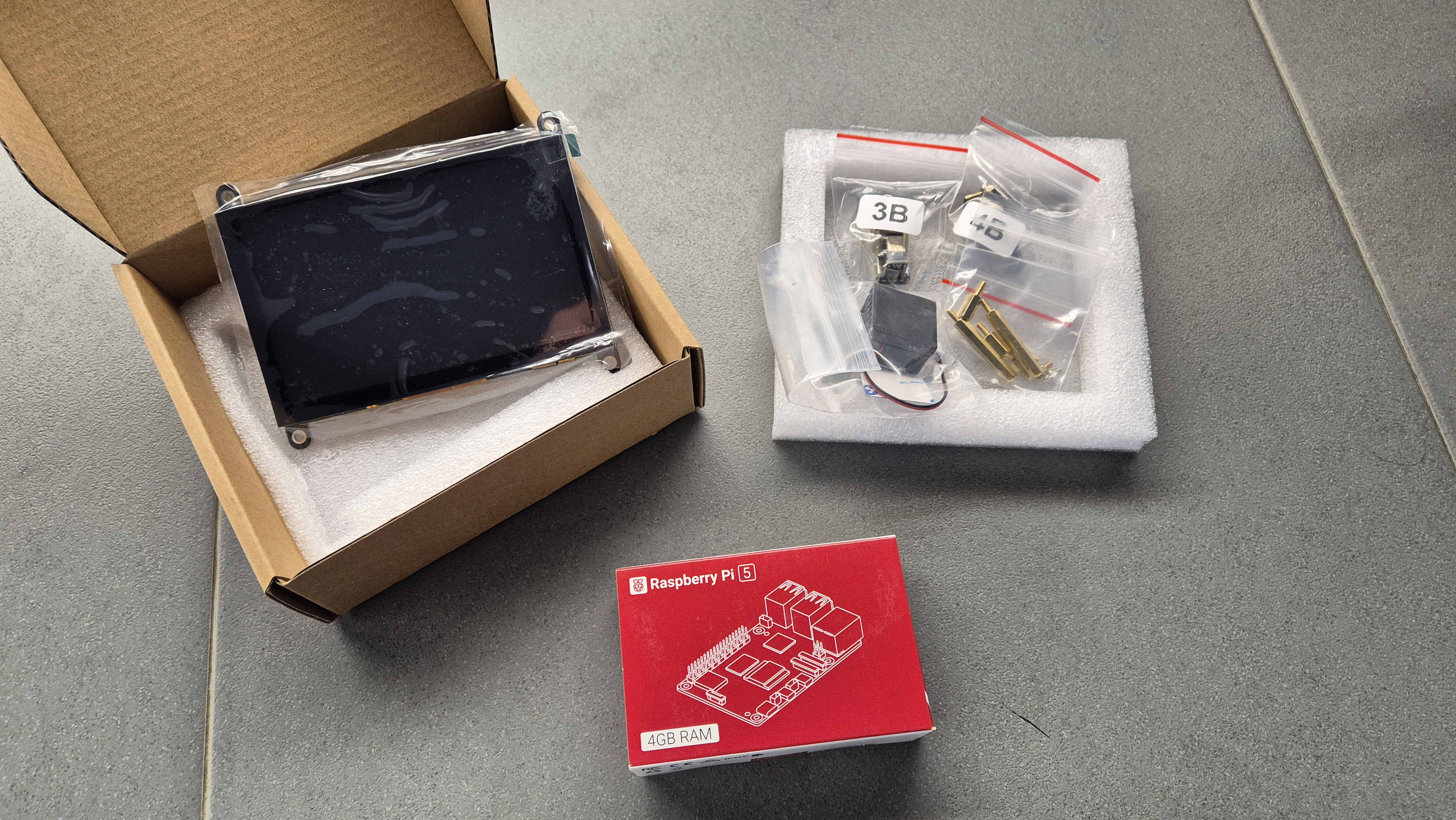

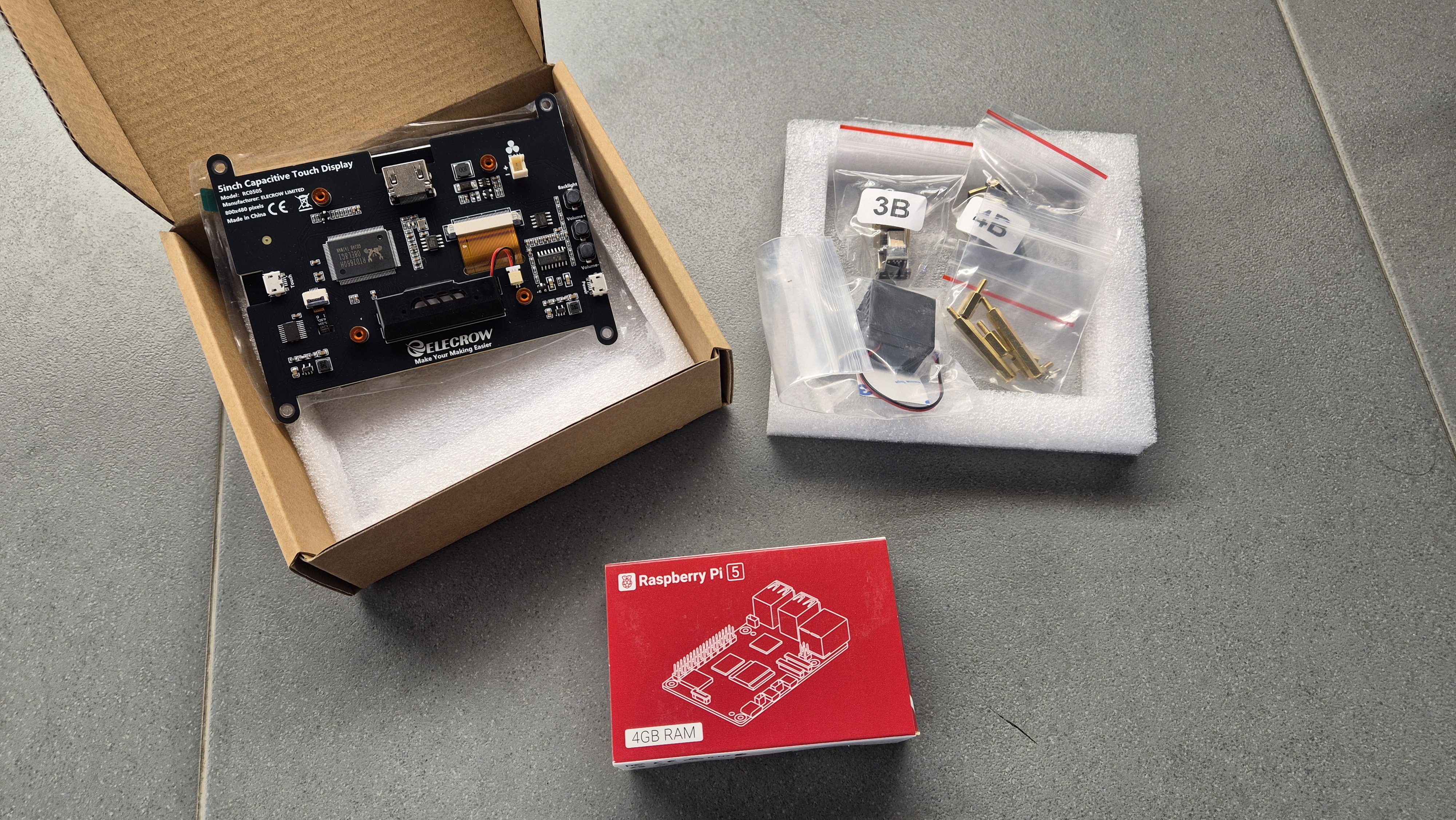

The RC050S package includes:
  • 5-inch monitor
  • 2x HDMI connectors
  • 2x USB connectors
  • 4x M2.5*4mm screws
  • 4x small copper pillars
  • 1x small fan
  • 2x long copper pillars
  • 2x short copper pillars
  • 1x user manual
