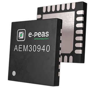

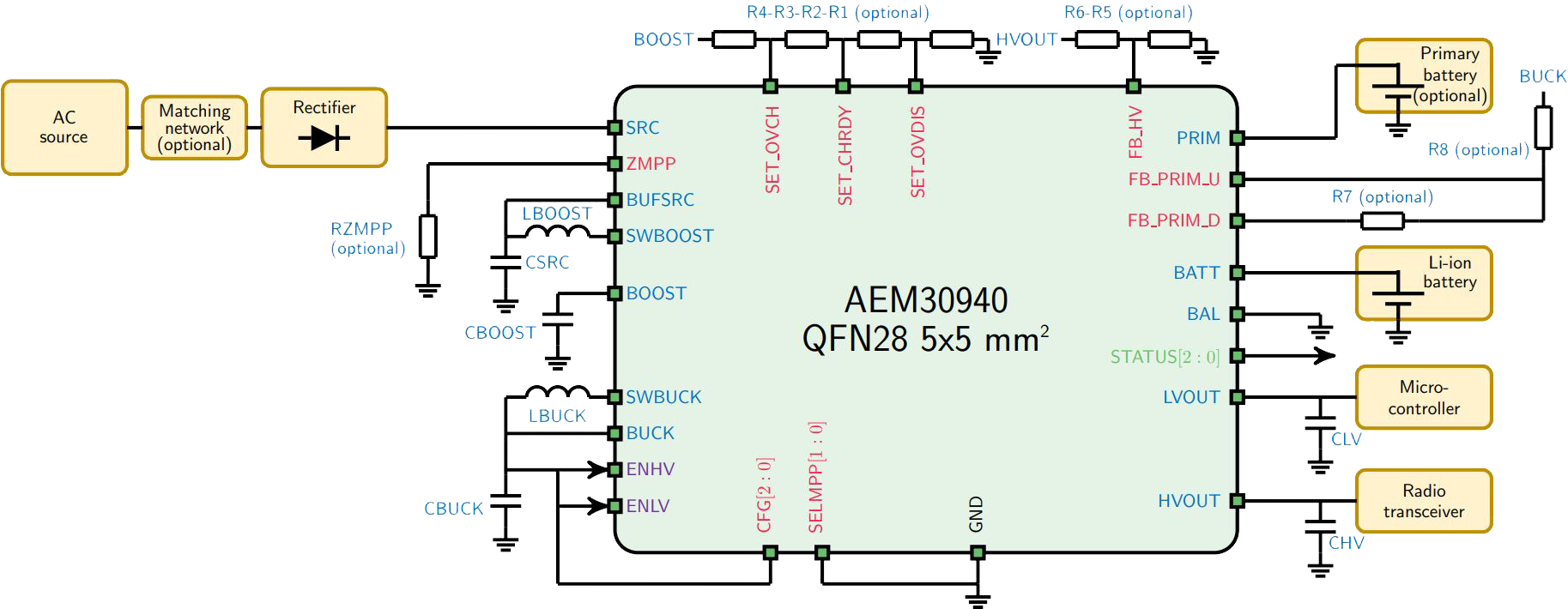

The new multifaceted energy harvesting solution is unique to the market. It consists of an e-peas AEM30940 high-performance power management IC (PMIC) accompanied by a TCT current transformer featuring one of the company’s proprietary high-permeability ferromagnetic cores. The current transformer is clipped around the cable. The AC current it extracts via induction from the cable is subsequently converted into a DC current using rectification circuitry, and the AEM30940 can then utilize this to power the electronic system it is connected to.

Block Diagram
