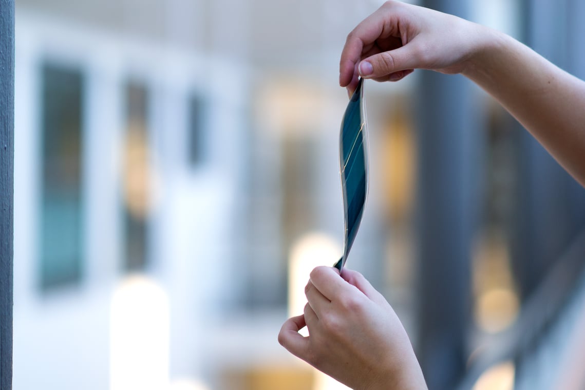

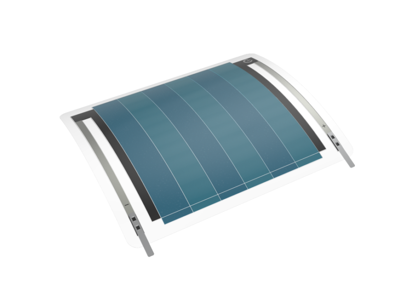

Epishine has developed a solar cell optimized for indoor use. The light energy harvesting (LEH) modules are optimized to convert light from indoor lighting into enough energy to power small electronic devices.
The LEH module is only 0.2mm thick, making it straightforward to fit into different devices without adding thickness to it. The module also fits on curved surfaces with a bending radius of 10mm.
The module can be connected more or less directly to the application for applications that only require to be powered when there is light, like an access card or a thermometer.
In applications where power is needed, even when there is no light available or if the momentary power required is more than the LEH module can deliver, an energy storage solution like a small super cap or rechargeable battery can be implemented. The LEH module charges the energy storage when light is available, and the storage solution power the application when needed.
Examples of applications built in this way are sensors that communicate wirelessly, including temperature and humidity sensors or fire detectors.

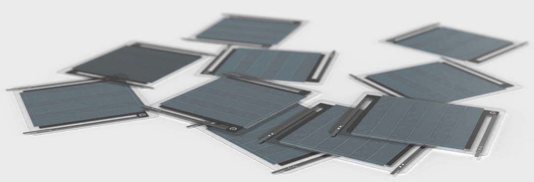

Its standard sizes of cells have an active area of 50mm by 20, 30 or 50mm.
