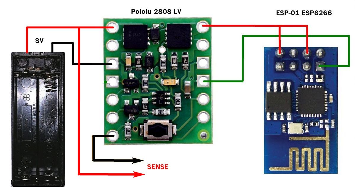

Peter’s project includes a simple water sensor and ESP8266 wifi module connected with power switch circuit. When the water reach a specific threshold, the sensor will trig the switch to turn on the ESP8266, which will connect to a wireless network and send a message to a web server.

Mini Pushbutton Power Switch from Pololu, an electronics manufacturer and an online retailer, is the power switch circuit used in this project. It is a $4 power control alternative to bulky mechanical switches which is able to turn on and off any device using the mini push button on the board, the external on & off pins, or a control signal. This low-voltage version operates from 2.2 V to 20 V and can deliver continuous currents up to around 6 A.

sensorThe sensor which is used to detect the overflow is very simple, it is just two wires pinned inside the tank above the highest level that water should reach. One of these wires is connected t
o the Vin pin, and the other is connected to CTRL pin on the switch circuit. DC current will flow between the two wires when the water pass the limit sending a control signal to turn on the Wifi module.
This combination is powered by a range of 3 volts to 3.6 volts battery pack. The circuits should be connected as shown in the diagram:
