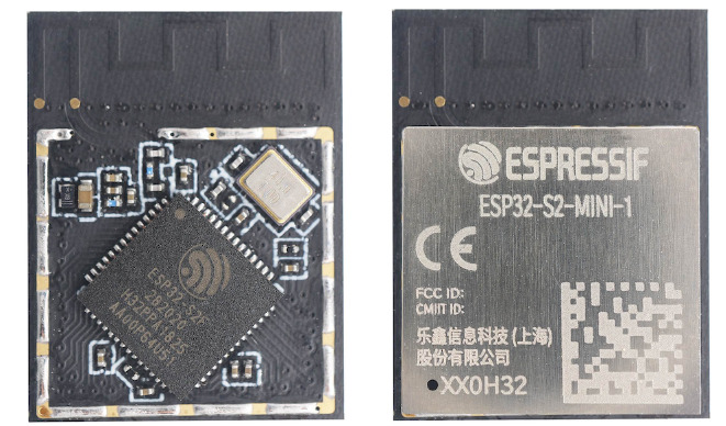

  • ESP32-S2-MINI-1 – PCB antenna

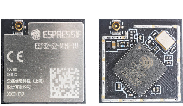

  • ESP32-S2-MINI-1U – IPEX antenna connector

  • ESP32-S2-MINI-1 – 20 x 15.4 x mm
  • ESP32-S2-MINI-1U – 15.4 x 15.4 x mm.
