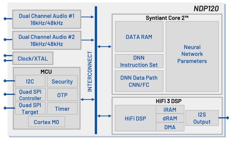

One Syntiant Core 2 U-LP deep neural network inference engine, one Tensilica HiFi 3 Audio DSP, and one Arm Cortex M0 (up to 48MHz), 48KB of static random access memory (SRAM) are all included in the Syntiant NDP120.

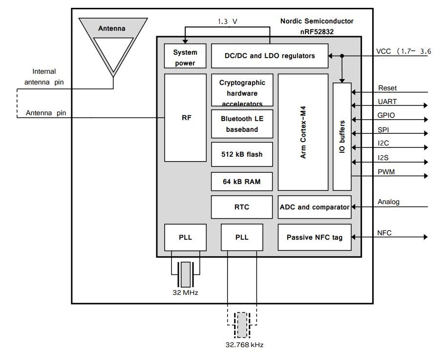

The nRF52832 features an Arm Cortex M4 processor (up to 64 MHz), 64KB of SRAM, and 512KB of Flash-mapped FIFOs. Further, it has a 12-bit/200 ksps ADC, 2.4-2.4835 GHz BL 5.0 (through the ARM Cordio stack), and 4.2 (via ArduinoBLE). Not only that but there’s also a 32MHz oscillator on the inside and a 1.8V power supply.
NDP120 block diagram
ANNA B112 block diagram
This datasheet clearly states that  NDP120 supports “concurrent neural networks, 2D convolution, depth-wise convolution, the recurrent neural network including LSTM and GRU, average and max pooling”.

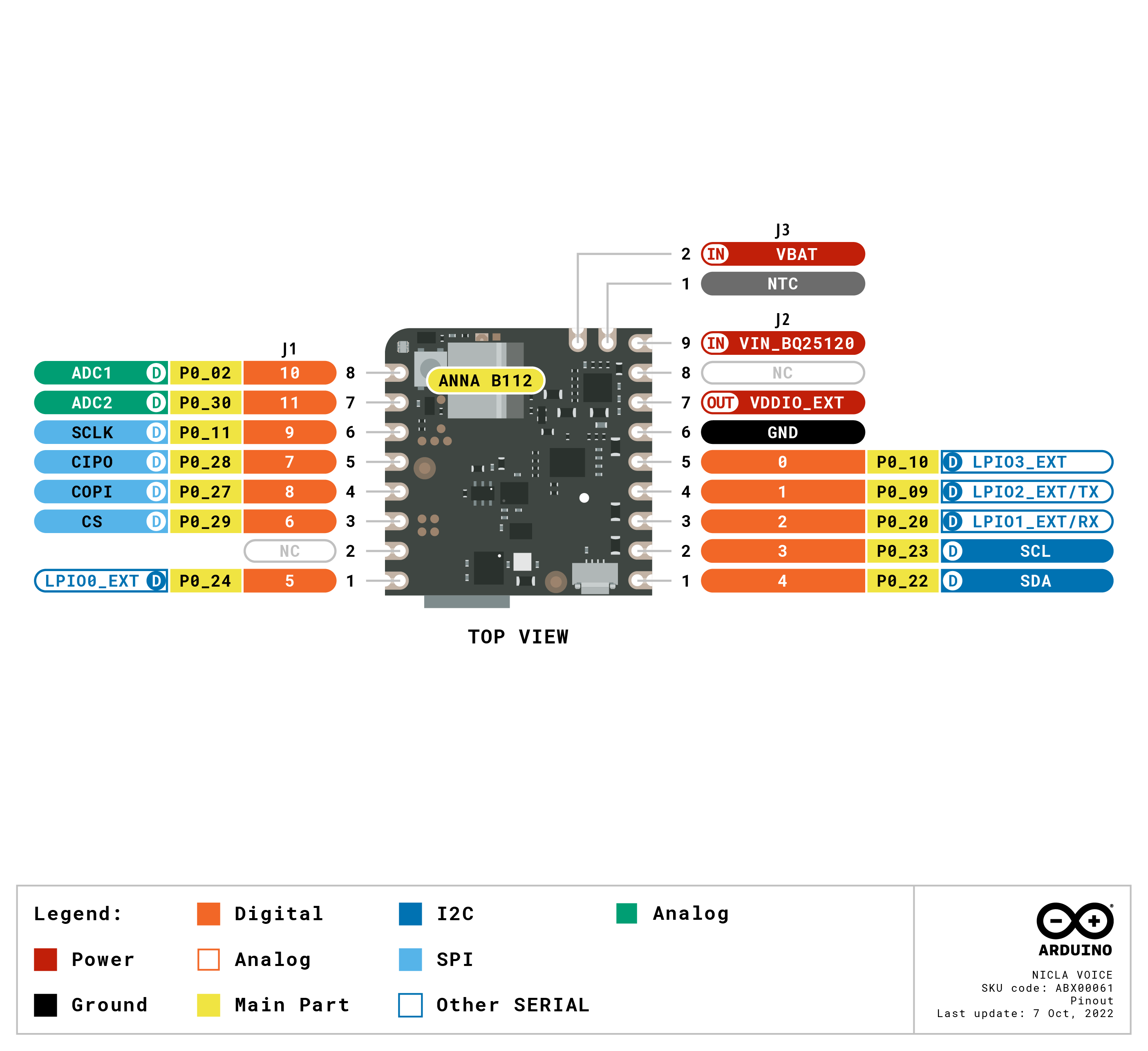

Arduino Nicla Voice pinout

The Arduino Nicla Voice has a list of specs, such as 16 MB SPI Flash storage, BLE 5.0, and Bluetooth mesh connectivity. I/O Interfaces are done through GPIOs 1.8V/3.3V, 10x Digital I/Os, 12x PWM pins, 1x I2C bus (with ESLOV connector), 1x UART, 1x SPI, and 2x ADC. The 6-Axis IMU (BMI270) and 3-Axis IMU (BMM150), 1x Digital MEMS Microphone (IM69D130), and 1x RGB LED are some of the other features. The USB is a Micro-B port. The temperature range is 0°C to 70°C. It gets its power from a 3.3V USB-B Micro port, a 3.7V Li-Po battery, and a JST connector. The size and weight are both 22.86 x 22.86 mm and 2g.
