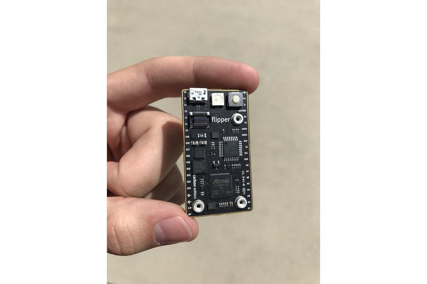

The Flipper: Carbon board is powered by an Atmel ATSAM4S16B Arm Cortex-M4 SoC, which featured 1MB of Flash Memory, 128KB of SRAM and it allows up to 8Mb of external Flash storage. Just like every other board, it provides support for up to 32 GPIO, I2C, SPI, USART, ADC and a 8-bit DAC. It comes with one ATMega32U2 that handles the code uploading from USB to the main MCU.
The board is not totally 5V tolerant, most of the pins are only 3.3v compatible and any 5V passed through those might likely damage the board.
