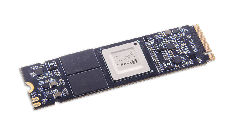

Geniatech AIM-M-K is an M.2 AI accelerator with NXP Ara-240 NPU, 40 TOPS performance, and support for LLMs and vision AI workloads.
Geniatech AIM-M-K M.2 2280 AI accelerator
The landscape of Edge AI grows in prominence and the two core pillars for industrial applications are computational density and deployment compatibility. Geniatech’s new AIM-M-K AI acceleration module with NXP Ara240 NPU allows to move from standard computer vision tasks to the edge deployment of large language models (LLMs). The SSD has a standard M.2 2280 (M-key) form factor and connects via a PCIe Gen4 x4 interface, which means it can be added to existing x86 and Arm-based systems without the need to change the base hardware.
The AIM-M-K acceleration module supports running Transformer-based architectures on edge devices, overcoming the traditional memory limitations, with up to 16 GB LPDDR4 onboard memory. AIM-M-K is purpose-built for edge inference workloads, with up to 40 TOPS of INT8 performance for generative AI and computer vision applications.
Previously, we covered the Forlinx FAI-ARA240-M, another M.2-based AI accelerator powered by the NXP Ara240 processor. We also covered the Radxa AICore AX-M1 Edge AI accelerator, which features 8GB LPDDR4X RAM and 8K Ultra HD video support. Feel free to check them out.

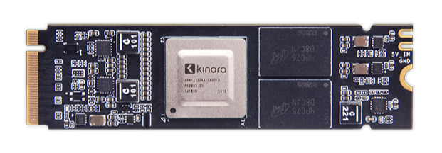

M.2 AI Accelerator Top
Geniatech AIM-M-K Specifications:
  • AI Accelerator: NXP Ara-240 NPU
  • AI Performance: Up to 40 TOPS
  • Memory: 16GB LPDDR4 onboard memory (8GB optional)
  • Supported AI Frameworks: TensorFlow, PyTorch, ONNX
  • AI Benchmark Performance
    • Stable Diffusion 1.4: 7 seconds per image
    • Llama2-7B: 12 output tokens per second
    • MobileNetV1 SSD: 974 IPS with 1.03 ms latency
  • Host Platform Support: Compatible with x86 and Arm processors
  • Interface:
    • M.2 M-Key
    • PCIe Gen4 x4 interface
  • Security Features:
    • Secure Boot support
    • Root-of-trust processor
    • Encrypted interface protection
  • Power Requirements
    • Operating Voltage: DC 3.3V
    • Power Consumption:
      • TDP: 12W
      • Typical: 3W
      • Full Load: 8W
  • Thermal Solution: Integrated heatsink cooling
  • Environmental Specifications:
    • Operating Temperature: 0°C to 50°C
    • Storage Temperature: -40°C to 85°C
    • Operating Humidity: 5% to 90%
    • Storage Humidity: 5% to 95%
  • Module Size/Thickness: 22 × 80 mm M.2 2280 form factor, 0.9 mm PCB thickness

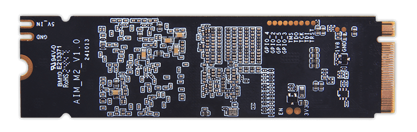

M.2 AI Accelerator Bottom
