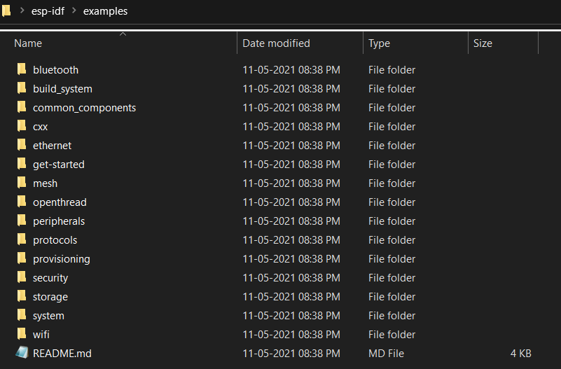

The ESP-IDF folder also contains some more programs to test out with instructions included in README.md file like Bluetooth, ethernet, wifi, security, protocols, peripherals etc.
Examples folder for ESP32-C3-DevKITM-1 on ESP-IDF

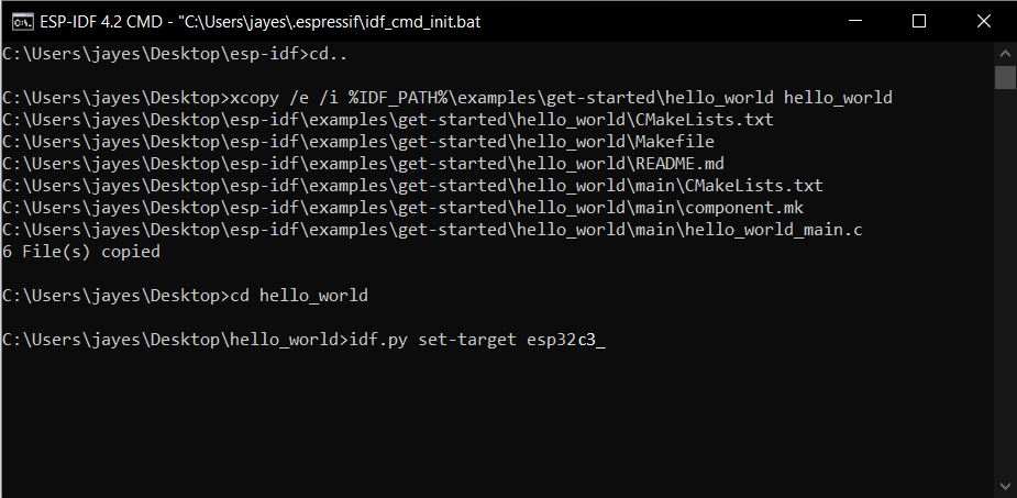

Just remember to set a target for the board you are working with. In this case for ESP32-C3-DevKITM-1, you need to execute idf.py set-target esp32c3
Setting Target

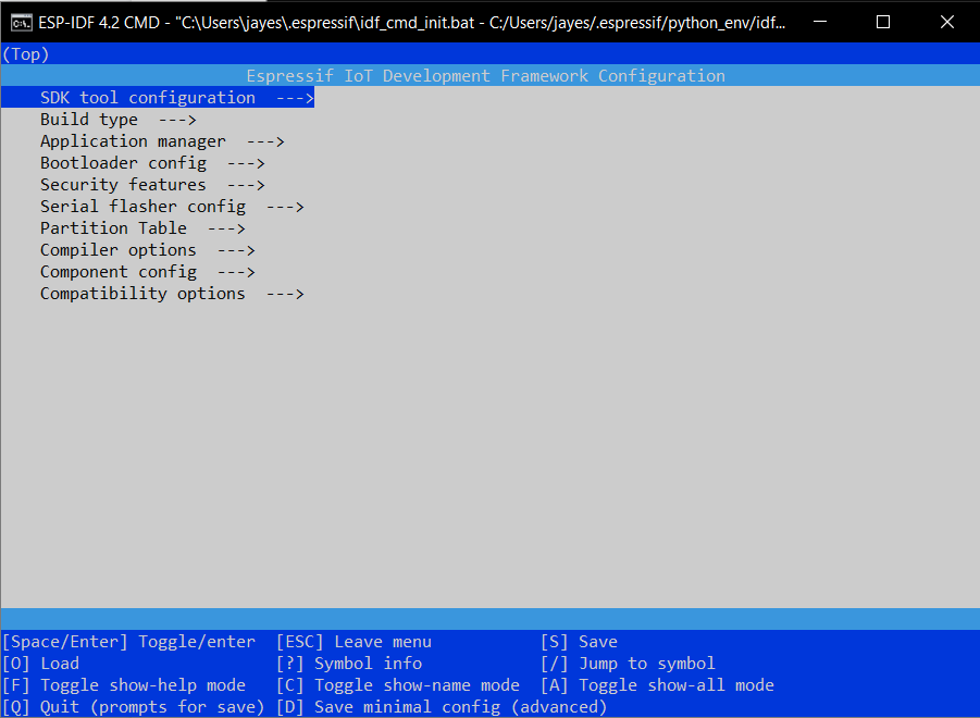

Suppose you get an error in flashing the code regarding the revision of ESP32-C3-DevKITM-1. Go to Idf.py menuconfig -> Component config -> ESP32C3-Specific -> Minimum Supported ESP32-C3 Revision -> REV2 -> Save and Esc, and then you can build, flash your program to your board.
ESP-IDF Console
