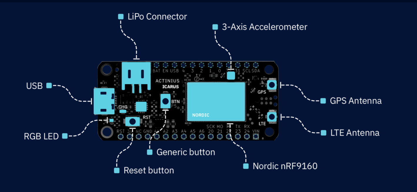

This 50.8mm X 22.8mm board can be used anywhere and anytime as it can be powered from any combination of battery, USB, or VIN (e.g. solar panel). It operates on a nominal operating input voltage of 4.35V – 10.2V and a maximum input voltage (safe rating) of 28V. The board is fully form-factor compatible with the Adafruit Featherwing, so you can install several extra components to the extension pins. It has an in-built over-voltage and under-voltage protection, with a USB-friendly Li/Ion/LiPolymer charger with MPPT, low-noise and incredibly low power consumption rate with power supply output up to 400mA.
Board Layout

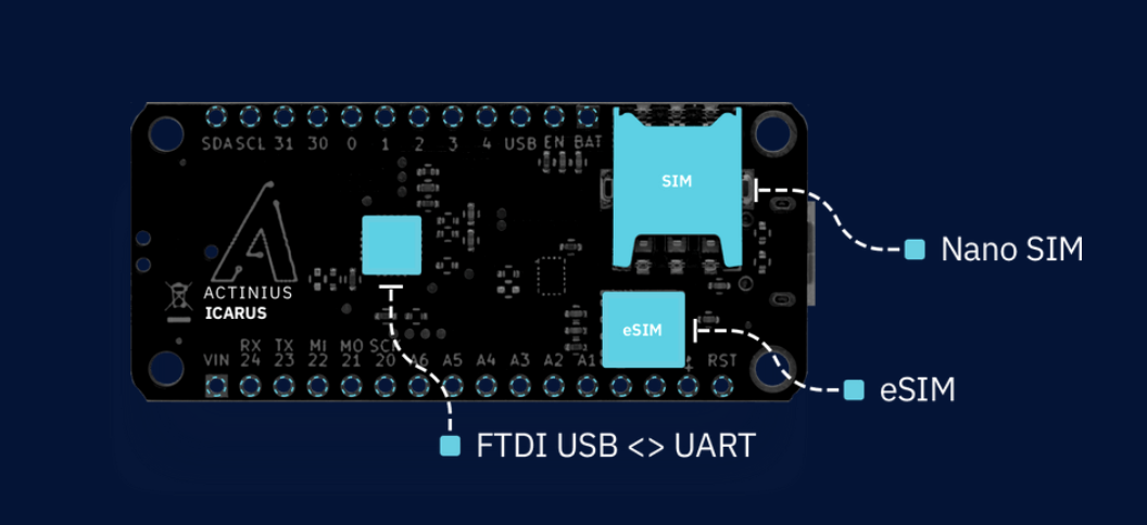

The Icarius IoT board is a true IoT development board with several connectivity options including a Nano-SIM and Embedded SIM, support for LTE Cat-M1 and LTE Cat-NB1 aka NB-IoT providing Global coverage with PSM and eDRX being  supported. It also onboard supports security with several features including; the ARM® Trustzone®, the ARM® Cryptocell 310, SSL/TLS support, and it’s being supported by the OTAU Platform of Actinius for always secure and up-to-date firmware.
For sensors and on-board peripherals, the board uses RGB Led, GPS, reset and general-purpose buttons, battery voltage reader and a low power 3-axis accelerometer. Other great specs include:
