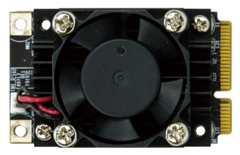

The ITG-100AI is pre-installed with a Mustang-MPCIE-MX2 AI accelerator card, which includes two Intel® Movidius™ Myriad™ X VPU, to provide a flexible AI inference solution. VPU is short for vision processing unit.
VPU is short for vision processing unit. It can run AI faster, and is well suited for low power consumption applications such as surveillance, retail and transportation. With the advantage of power efficiency and high performance to dedicate Deep Neural Networks (DNN) topologies, it is perfect to be implemented in AI edge computing device to reduce total power usage, providing longer duty time for the rechargeable edge computing equipment.

Mustang-MPCIE-MX2
Mustang-MPCIE-MX2
Ultra-compact Size
Space limitation is one of the constraints commonly seen in today’s industrial environment. Under tight restrictions, the ITG-100AI-AL not only provides palm-sized design to meet the space requirement, but also comes with adequate basic I/O interfaces for various applications.

  • Pre-installed Mustang-MPCIE-MX2, 2 x Intel Myriad X VPU for AI deep learning workload consolidation
The ITG-100AI is available now at an undisclosed price. More information may be found in IEI’s announcement and product page. More on the Mustang-MPCIE-MX2 module may be found on the Mustang-MPCIE-MX2 product page.
