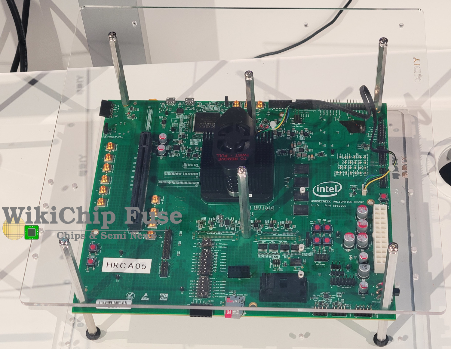

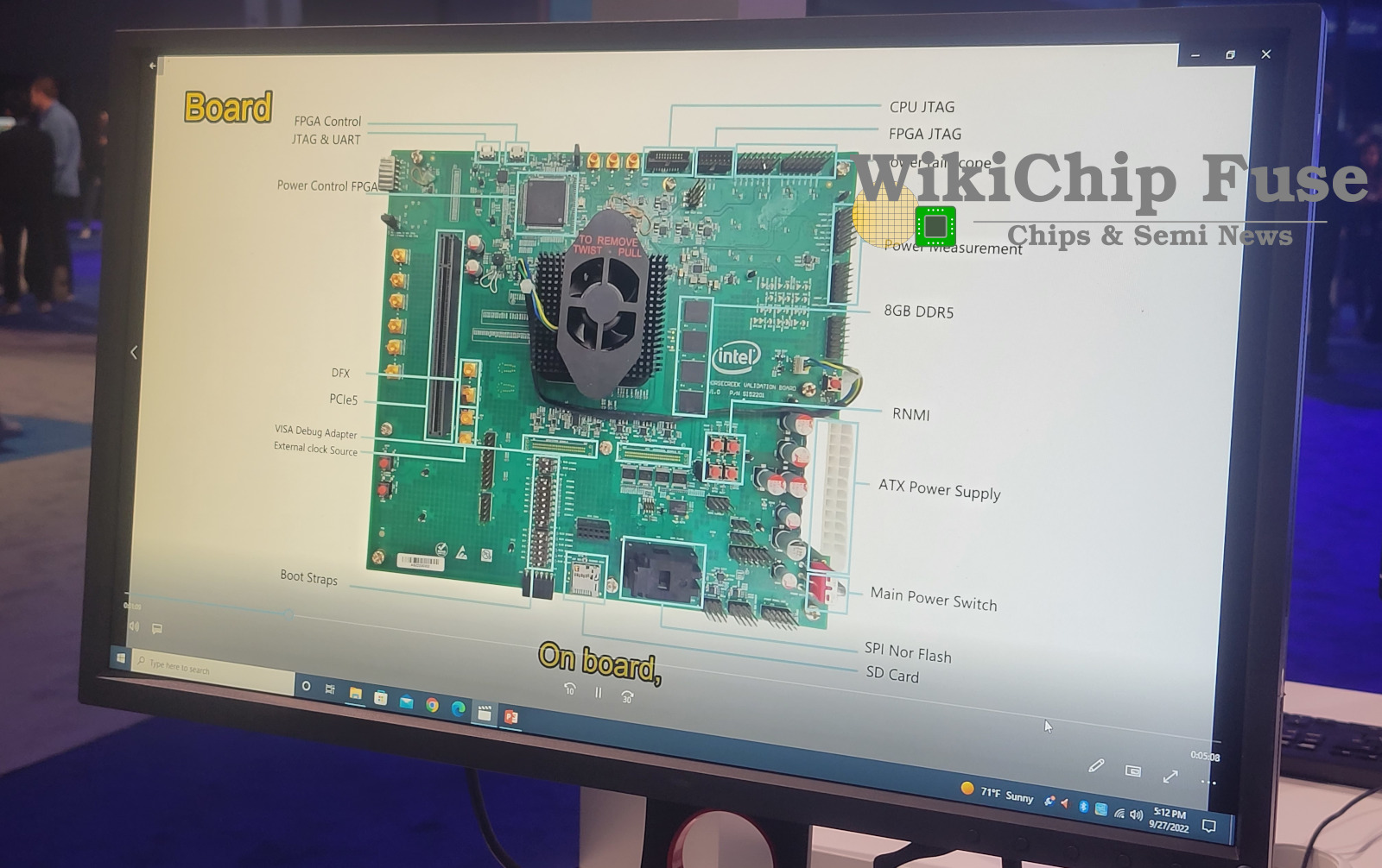

A prototype of the dev platform was showcased for the first time during the Intel 2022 Innovation Developer Conference held earlier this year. The Horse Creek is a Raspberry-Pi-inspired RISC-V software development board integrated with 8GB of DDR5 memory, PCIe 5.0 slot, SPI Flash, an SD card reader for storage, Linux-based software, and of course, a Cortex-A75 quad-core RISC-V processor running at up to 2.2 GHz, each core featuring private L1 and L2 caches with a shared last-level cache. No built-in GPU but the CPU should be powerful enough to perform basic computing tasks on its own since Intel demonstrated it executing a video game along with various other applications.

  • Processor
    • SiFive P500 quad-core processor @ up to 2.2 GHz with:
    • a 13-stage, 3-issue high-performance out-of-order pipeline
    • Each core has private 32KB + 32KB L1 cache and 256KB L2 cache
    • Up to 4MB L3 cache in a quad-core cluster
    • a SPECint 2006 score of 8.65/GHz
  • Memory
    • DDR5-5600 interface
  • PCIe
    • Intel PCIe 5.0 PHY with x8 lanes
    • Synopsys PCIe Root Hub Controller
  • Others
    • I3C, Quad and Octal SPI, UART, peripheral DMA
  • Package
    • 19 x 19 standard FBGA Package
  • Process
    • Most advanced Intel 4 Process Technology
  • Software
    • Supports Ubuntu 20.04 with Linux 5.17.4
