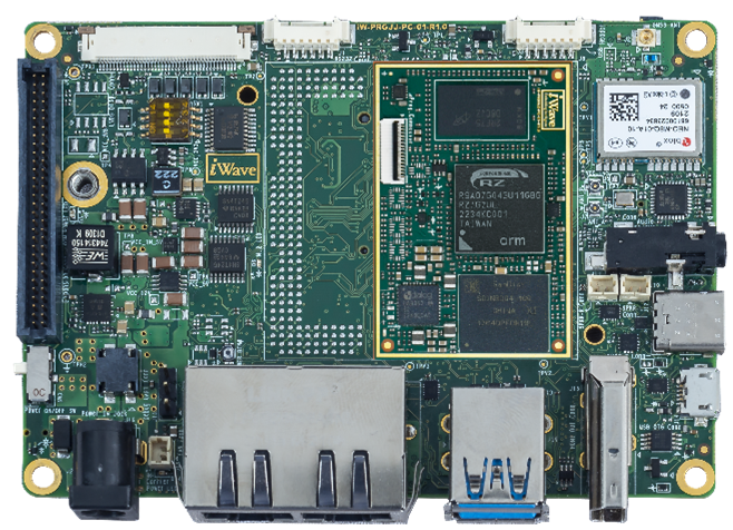

iWave Systems announced an upcoming iW-RainboW-G53M: RZ/G2UL, RZ/A3UL, RZ/Five based System on Module (SOM) built on OSM v1.1 Size-M specification at the Embedded World 2023 trade fair. The module delivers sophisticated features and enhanced performance for IoT endpoint devices while reducing overall costs.
RZ/G2UL, RZ/A3UL, and RZ/Five MPUs are available with the same pin package enhancing the compatibility of the SOM architecture. Using the same pin package assignment and peripheral functions across different MPUs, the SOM lets the customer choose either the Cortex-A55 core to target Linux-based HMI applications or the RISC-V AX45MP core, depending on their needs.
The same board design can be adapted to develop new products simply by replacing the chip. In addition, this compatibility enables an engineer to easily transition the development platform from RTOS to Linux-based products, enabling efficient product development across multiple platforms.

RZ/G2UL, RZ/A3UL, RZ/Five SOM is mounted on a carrier board as a Single Board Computer (SBC), which can also be used as an evaluation kit. This feature-rich multimedia insert-ready SBC is available in Pico-ITX form factor, and is a great candidate for many IoT and embedded applications.
