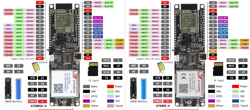

The ESP32-WROVER-E module, based on an ESP32 dual-core processor operating at 240 MHz and includes 4MB Flash memory and 8MB PSRAM, drives these boards. For superior connectivity, it gets the support of WIFI 4 and Bluetooth 4.2/ 5.X technology along with the PCB antennas. The new T-A7068X boards support GPS since they are also providing a GPS antenna. It also consists of I/O expansions including two 16-pin headers which permit the expansion of these boards even with RS485 and CAN bus interfaces. These I/O expansions also support GPIOs, ADC, DAC, touch interface, UART, I2C, SPI, VN/VP, Reset, VBUS, VBAT, 3.3V and GND. The detailed pinout details for T-A7608E-H & T-A7608SA-H are given below.
 T-A7608E-H & T-A7608SA-H Pin Diagram
