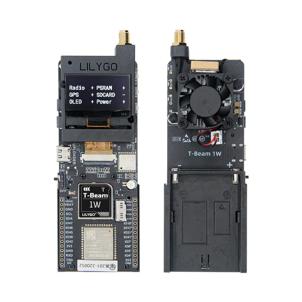

LilyGo T-Beam-1W Top View
LilyGo T-Beam-1W

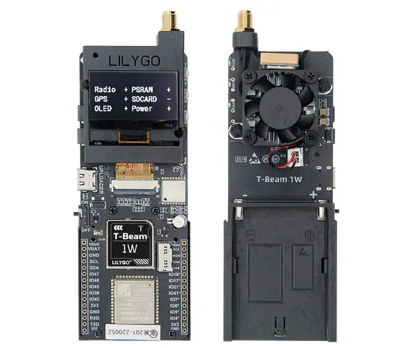

LilyGo T-Beam-1W front and back

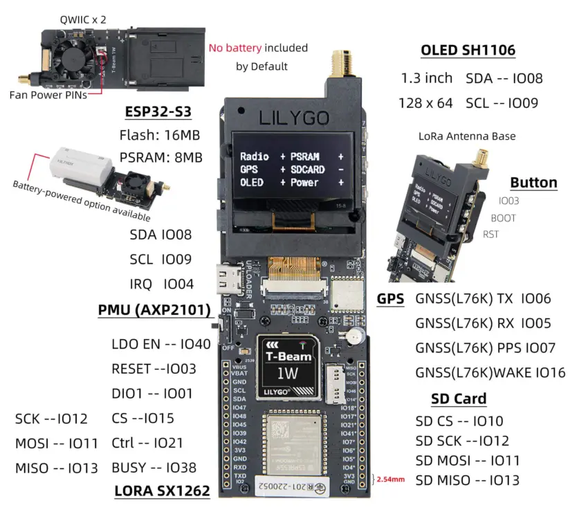

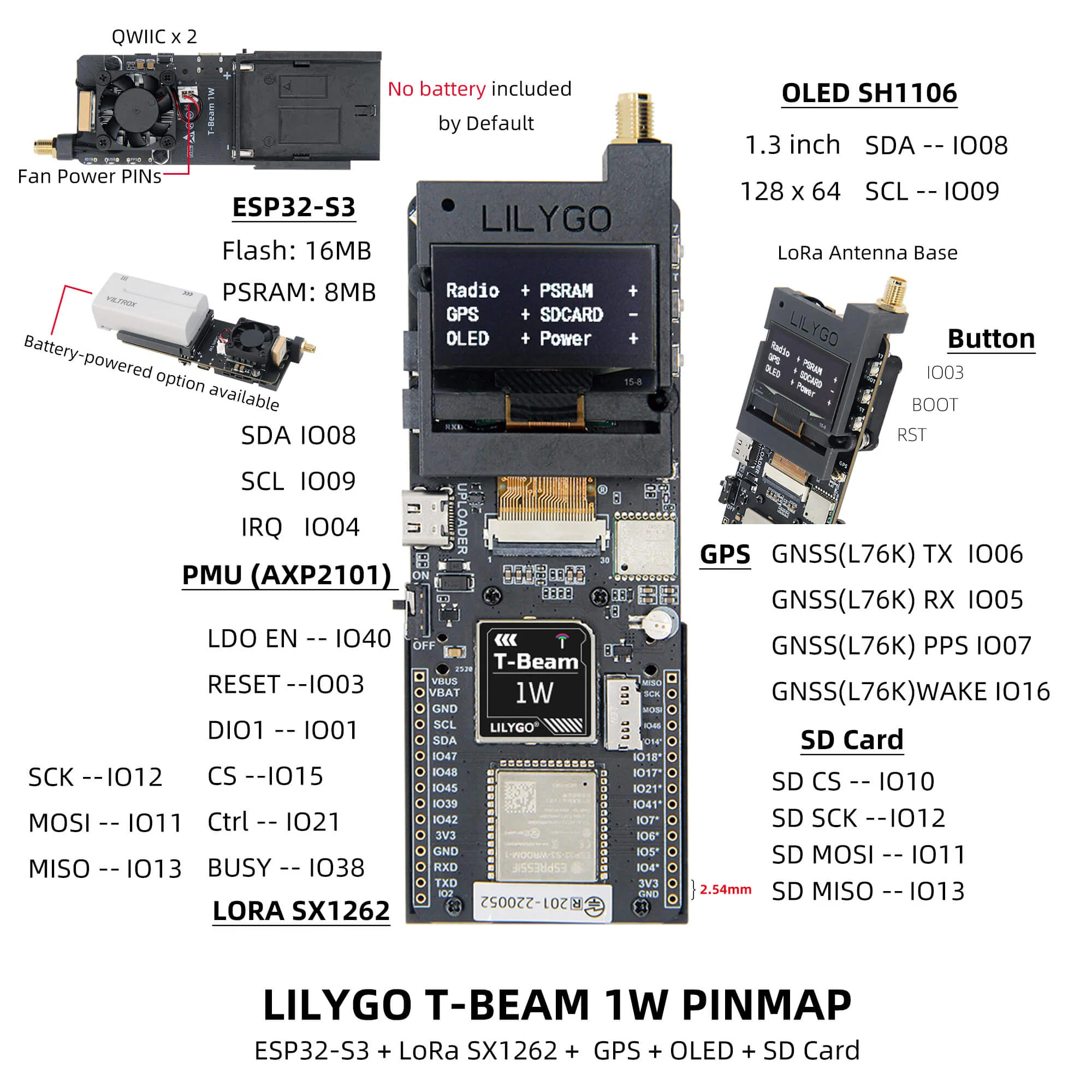

LILYGO-T-BEAM-1W pinmap

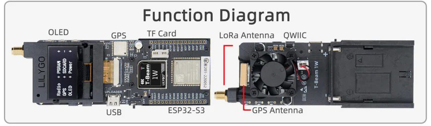

LilyGo T-Beam-1W Function Diagram
