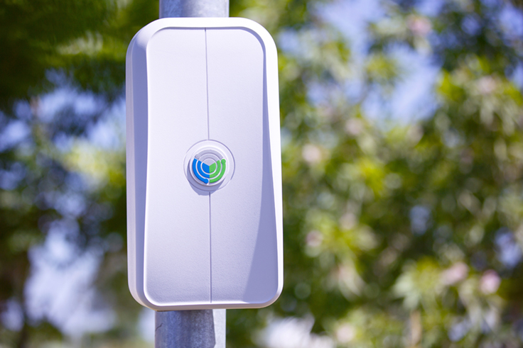

Facebook this time is trying to find a general solution to improve the connectivity infrastructure. The project called OpenCellular.
This new project is a software-defined wireless access platform, and this gives it the ability to support everything from 2G to LTE networks.

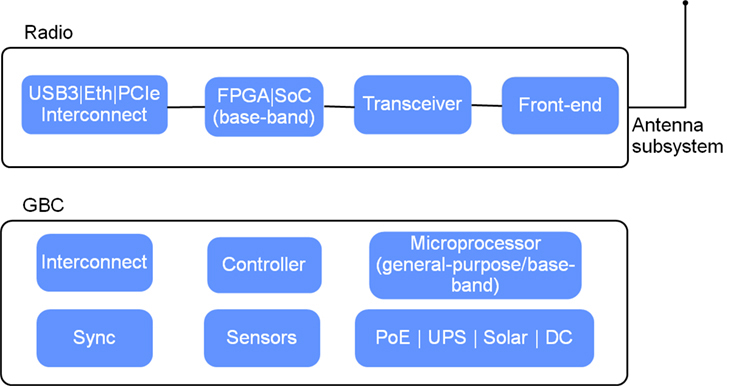

The system consists of general-purpose and base-band computing subsystem with integrated power and housekeeping system and a RF with integrated analog front-end. According to the announcement, Facebook plans to open-source the hardware designs to public, along with necessary firmware and control software.
OpenCellular designed to have various power sources: PoE (power-over-ethernet), solar, DC, and external batteries and internal battery (lithium-ion).
