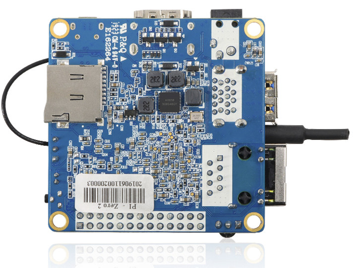

Orange Pi Zero2 is a Tiny Allwinner H6 SBC with HDMI 2.0, USB 3.0, Ethernet & WiFi
Shenzhen Xunlong Software is introducing a new, compact SBC to the market. The Orange Pi Zero2 is a little bit larger than its predecessor and more powerful to boot.
Shenzhen Xunlong Software is introducing a new, compact SBC to the market. The Orange Pi Zero2 is a little bit larger than its predecessor and more powerful to boot. The board comes with an Allwinner H6 SoC that incorporates four ARM Cortex-A53 cores, 512 MB of LPDDR3 RAM, 4 GB of eMMC flash storage and a host of interfaces, and it still weighs just 34 g. Pricing and availability are still unconfirmed but expect it to cost around US$20. Shenzhen Xunlong Software is quite occupied lately. They only recently released a refreshed version of Orange Pi Zero, known as the Orange Pi Zero LTS. Now it is working on the Orange Pi Zero2, the aptly named successor to the Orange Pi Zero, which seems to offer more performance and possibilities than its predecessor.
The SBC is based on an Allwinner H6, an SoC that integrates four ARM Cortex-A53 cores and an ARM Mali-T720 GPU alongside other components. The Pi Zero2 also supports OpenGL through to ES 3.1 and DirectX 11. Shenzhen Xunlong Software equips the Allwinner H6 with 512 MB of LPDDR3 RAM and 4 GB of eMMC flash storage. The Pi Zero2 also supports up to 32 GB microSD cards in case you need additional space. The board also includes a full-sized HDMI 2.0a port, which is quite rare among small SBCs.
The Pi Zero2 offers support for all modern Wi-Fi standards up to IEEE 802.11 n too, and also Bluetooth 4.2, and 100 MBit Ethernet. Gigabit Ethernet would have been preferable, but we will settle for the board’s USB 3.0 and USB 2.0 connections. To sweeten things, there is a 26-pin Raspberry Pi header too, along with a 3-pin UART header for serial console debugging. The SBC needs 5 V for power, and it can be supplied either through a USB OTG or a DC jack. The Pi Zero2 measures 55 x 55 mm and weighs just 34 g. The board should offer support for Android 7.0, Debian and Ubuntu, although, we should note that these pre-release OS lists are not always complete or correct, so we might see something different later. Shenzhen Xunlong Software is also silent about pricing and availability, although we should expect the Pi Zero2 to sell for around US$20, going by the price of previous Orange Pi devices.
Orange Pi Zero2 specifications:
  • SoC – Allwinner H6 quad-core Arm Cortex-A53 processor with Arm Mali T720 GPU with support for OpenGL ES3.1/3.0/2.0/1.1, Microsoft DirectX 11 FL9_3
  • Memory – 512MB LPDDR3 (Allwinner AW52A8G32)
  • Storage – 4GB eMMC Flash and microSD card up to 32GB
  • Video Output – HDMI 2.0a port
  • Video Decoding – 10-bit H265/HEVC up tp 4K60 or 6K30; H264/AVC up to 4K30; VP9 up to 4K30; AVS+/AVS up to 1080p60
  • Network Connectivity
    • 802.11 b/g/n WiFi 4 + Bluetooth 4.2 via AP6212A module
    • 10/100M Ethernet
  • Audio – Built-in microphone, and HDMI digital audio output
  • USB – 1x USB 3.0 port, 1x USB 2.0 port; 1x micro USB 2.0 OTG port
  • Expansion – 26-pin “Raspberry Pi 1” header
  • Debugging – 3-pin UART header for serial console
  • Misc – Power & status LEDs, IR receiver, power key
  • Power Supply – 5V via micro USB OTG port or DC jack; A8038 PMU instead of the usual AXP805
  • Dimensions – 55 x 55 mm
  • Weight – 34 grams
