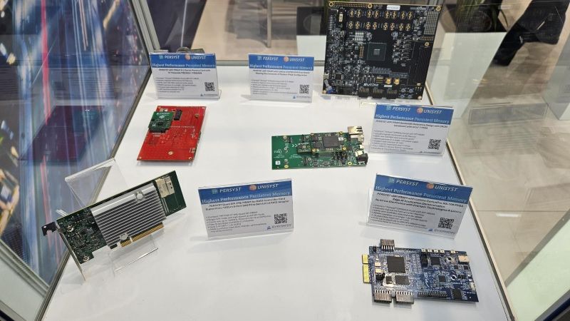

Everspin showcased its new UNISYST MRAM family at Embedded World 2026
Everspin showcased its new UNISYST MRAM family at Embedded World 2026. Image used courtesy of Everspin Technologies
