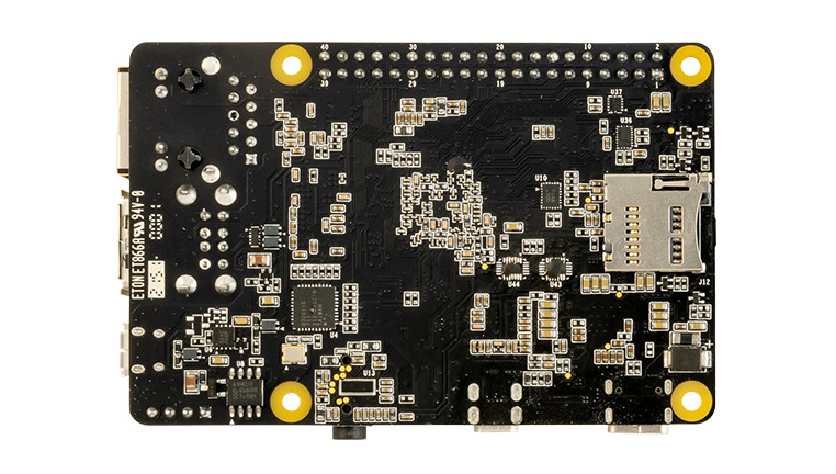

RZBoard V2L board comes in the format of a single-board computer and is based on the Renesas RZ/V2L processor, which supports the latest energy-efficient object detection. It has a powerful vision-AI acceleration engine and is available in a popular single-board computer format with well-supported expansion interfaces. The RZBoard is engineered in a compact Raspberry Pi form factor with a versatile set of expansion interfaces. You might be looking for a vision AI accelerated board to develop AI applications, then Avnet RZBoard V2L could be it.

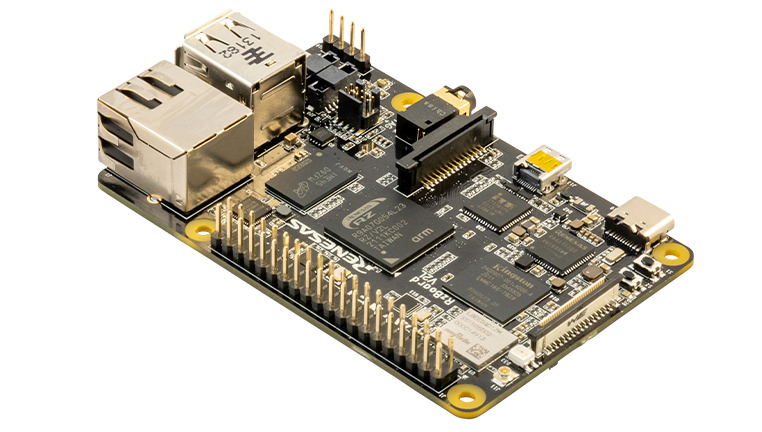

RZBoard V2L has made vision AI development easier, faster, and more cost-efficient with its Renesas RZ/V2L processor. This microprocessor consists of dual Arm Cortex-A55 cores clocked at 1.2 GHz, known for its high power efficiency and performance, in addition to a Cortex-M33 core clocked at 200MHz, especially suitable for IoT and embedded applications that need efficient security or digital signal control, MALI 3D GPU running at 500MHz which delivers the best 3D visual performance possible with an Image Scaling Unit providing good image quality and an on-chip DRP-AI accelerator.
RZBoard V2L board
Dynamically Reconfigurable Processor (DRP) AI accelerator is the key to the RzBoard’s low power consumption since it dissipates its heat without any external heat sinks or fans. Additionally, the DRP-AI has both real-time AI interference as well an image-processing function with camera capabilities such as color correction and noise reduction, which eliminates the need for an external image signal processor (ISP)
